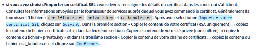

Dans le guide https://help.ovhcloud.com/csm/fr-web-hosting-ssl-certificates?id=kb_article_view&sysparm_article=KB0053177
