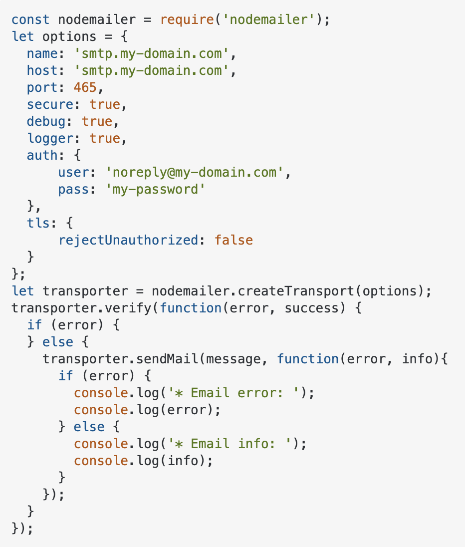

Our Node JS application uses the nodemailer module in order to send emails to our users. It uses the nodemailer's internal SMTP transporter that uses the OVH email address and password mentioned just before.

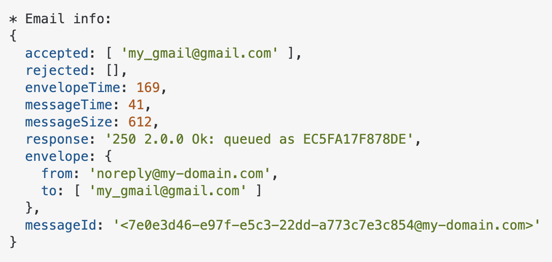

When we target the first server (thanks to its dedeciated subdomain and port), it is actually able to send emails to my Gmail account (or any other provider). I get this piece of information...
When we target the other server, I get the exact same type of logs. But I never receive this same email in my Gmail account.

As far as I know, as soon as Gmail accepts a mail it will show up in your Gmail mailbox, possibly in a spam folder. E-mails which are clearly spam are rejected by Gmail during the SMTP transaction, and never get a successful message such as "queued as XXXXX".

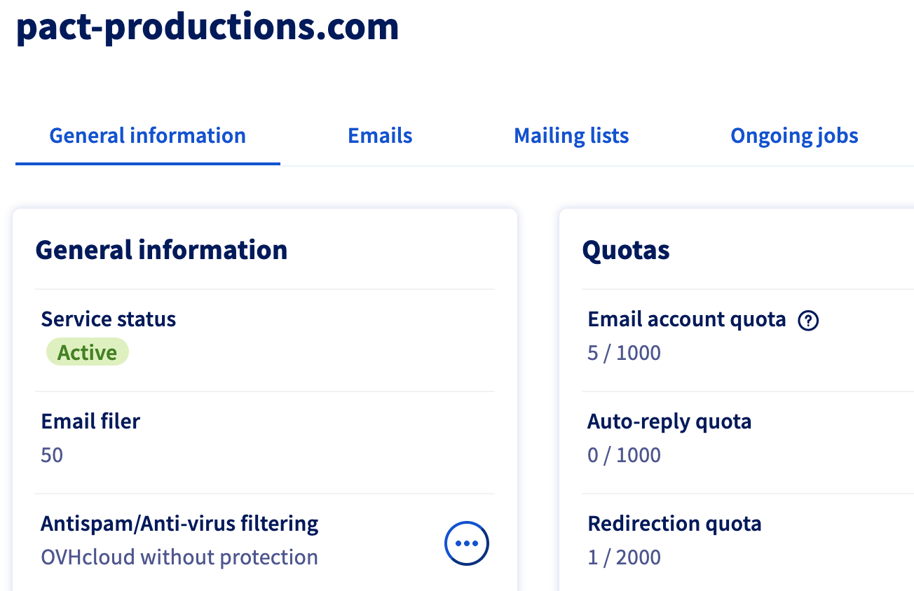

On the OVH manager, I tried to switch the "Antispam/Anti-virus filtering" to "OVHcloud without protection" with no luck. Server#2 's emails are still not received on my Gmail (I also checked SPAM).

Do you know more about possible SMTP quotas with the MX Plan? Can we check it somehow? Are SMTP quotas handled by server's IP or quotas are just overall checked by email account (noreply@my-ovh-domain.com). Maybe sever #2 exceeded the quota, and not server#1. Ain't it strange that quotas could exist without any mean to check it ?

I had the same info / logs form server #1 and #2, as shown in my 2nd screenshot in the first email, when using the Node app. Message was apparently sent. I had the same status (250), and got a message ID like GUID@1production.com.production.com.
