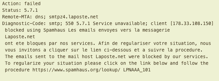

Reçu hier et aujourd'hui :
Diagnostic-Code: smtp; 550 5.7.1 Service unavailable; client [178.33.107.230] blocked using Spamhaus
Diagnostic-Code: smtp; 550 5.7.1 Service unavailable; client [178.33.108.150] blocked using Spamhaus

Je vois qu'il existe de nombreux sujets identiques mais pas de résolution simple. Voici le retour du jour depuis mon adresse pro :
This is the mail system at host mo2.1out.ovh.net.out.ovh.net.
I'm sorry to have to inform you that your message could not be delivered to one or more recipients. It's attached below.
The mail system
xxxxx.org>: host spool.mail.gandi.net[217.70.178.1]
said: 554 5.7.1 Service unavailable; Client host [87.98.181.248] blocked
using 1xbl.spamhaus.org;xbl.spamhaus.org; https://www.spamhaus.org/sbl/query/SBL465573
(in reply to RCPT TO command)
Action: failed
Status: 5.7.1
Remote-MTA: dns; spool.mail.gandi.net
Diagnostic-Code: smtp; 554 5.7.1 Service unavailable; **Client host**
** [87.98.181.248] blocked using 1xbl.spamhaus.org**xbl.spamhaus.org**
La réponse est ici
Ref: SBL465573
87.98.181.248/32 is listed on the Spamhaus Block List - SBL
2019-11-22 07:43:26 GMT | ovh.net
Abused / misconfigured newsletter service (listbombing)
The host at this IP address is being (ab)used to "listbomb" email addresses:
From: news@intimiti.pl
Subject: Daj się skusić już teraz! Nowości na Andrzejki
Problem description
Spammers signed up for the bulk email service using the victim's email address. As a result, the victim is being "listbombed" with transactional messages and bulk email campaigns.
87.98.181.248
