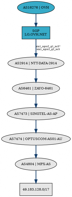

Normally, the latency for connecting from Australia to Singapore should be between 90-120ms, but I'm currently experiencing latency as high as 400ms. Here's traceroute:
traceroute to 51.79.144.122 (51.79.144.122), 60 hops max, 40 byte packets
 1  172.20.10.1 (172.20.10.1)  10.112 ms  3.746 ms  3.713 ms
 2  172.24.118.67 (172.24.118.67)  23.437 ms  38.986 ms  32.963 ms
 3  10.194.254.2 (10.194.254.2)  25.600 ms
    10.194.254.6 (10.194.254.6)  24.378 ms  29.783 ms
 4  10.194.121.209 (10.194.121.209)  32.435 ms
    10.194.121.213 (10.194.121.213)  21.206 ms  21.726 ms
 5  * * *
 6  124.19.61.33 (124.19.61.33)  26.855 ms
    59.154.18.53 (59.154.18.53)  21.744 ms
    59.154.57.180 (59.154.57.180)  24.091 ms
 7  61.88.33.25 (61.88.33.25)  35.014 ms  28.341 ms  23.643 ms
 8  bundle-ether46.ken-edge903.sydney.telstra.net (110.145.210.197)  19.623 ms  36.170 ms  30.981 ms
 9  ovh2410229.lnk.telstra.net (144.130.164.246)  30.832 ms  28.390 ms  30.952 ms
10  * * *
11  * * *
12  * * *
13  * * *
14  dfw-da2-sbb2-8k.tx.us (192.99.146.238)  213.457 ms  203.724 ms  219.118 ms
15  * * *
16  * * *
17  mrs-mrs1-sbb1-8k.fr.eu (54.36.50.135)  326.331 ms
    par-dpa1-sbb1-8k.fr.eu (57.128.121.10)  307.407 ms
    mrs-mrs1-sbb1-8k.fr.eu (54.36.50.135)  326.856 ms
18  mrs-mrs2-sbb1-nc5.fr.eu (57.128.121.185)  325.099 ms
    sin-sg1-sbb1-nc5.sgp.asia (103.5.15.31)  412.688 ms  411.009 ms
19  * sin1-sgcs2-g1-nc5.sgp.asia (103.5.15.5)  451.845 ms *
20  * sin-sgcs2-g2-nc5.sgp.asia (103.5.15.17)  419.746 ms *
21  * * *
22  * * *
23  * * *
24  * * *
25  * * *
26  * * *
27  vps-ef08a92a.vps.ovh.ca (51.79.144.122)  427.394 ms *  404.227 ms
And here's the Ping result:
--- 51.79.144.122 ping statistics ---
225 packets transmitted, 224 packets received, 0.4% packet loss
round-trip min/avg/max/stddev = 403.680/483.005/616.429/47.214 ms
As you can see, this is an extremely absurd path, from Australia to the United States, then to France, and finally to Singapore, where the latency exceeds 450ms.
Optus(AU) -> Telstra(AU) -> OVH(US) -> OVH(FR) -> OVH(SG) 403~616ms
I'd like to know what's wrong with OVH's network and when it will be fixed?
