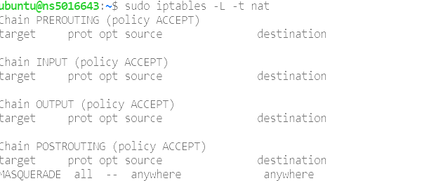

How do i configure the vrack interface on ubuntu server 22.04 which allows the interface to connect out to the internet?
I have setup the vrack interface with the ip subnet of 192.168.0.2/16.
However, when i attempt to do an outbound ping from the interface: enp3s0f1 with:
ping 8.8.8.8 -I enp3s0f1
I get Destination Host Unreachable
Does anyone know how to configure the vrack interface so that it is able to reach the external internet?
My NAT/Firewall Settings can been seen below:
my netplan configuration can be seen here:
