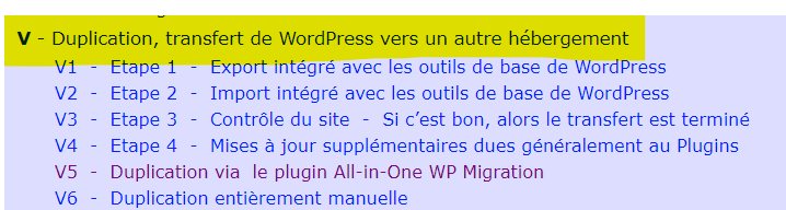

Extrait de mon guide :
**V5 - Duplication via le plugin All-in-One WP Migration :**
https://www.wordetweb.com/word-et-web/WORDPRESS-guide-installation-de-WordPress-premier-domaine-chez-OVH-FR.htm#_V5__-
