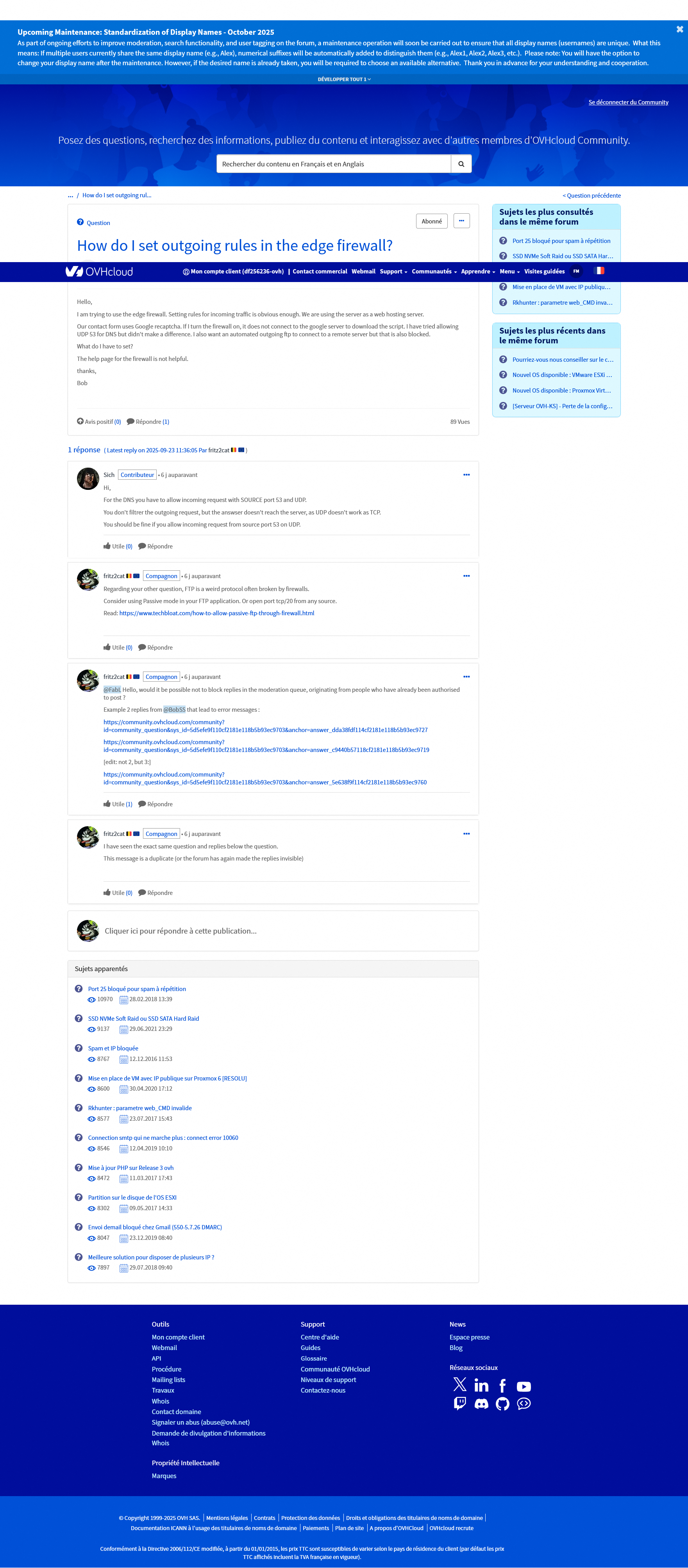

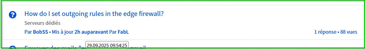

Hello,
Could some explain why:
Last modification date is today by@FabL but there is no reply from him
and worse: when I open the topic the forum reports that there is ONE reply from me, but several replies follow.
How is it possible that such discrepancies do occur ?
Screenshot of the entire browser window attached below.
I wanted to edit my reply above just to add: In fact my last message was caused by the disappearance of the previous messages, 6 days ago.
Unfortunately the button does no action, nothing happens and the updated text is not saved. Grrrr. This explains the addition of yet another reply.
