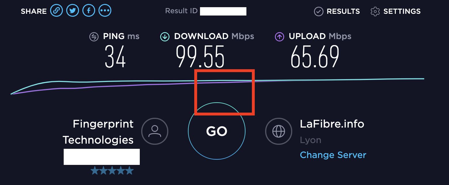

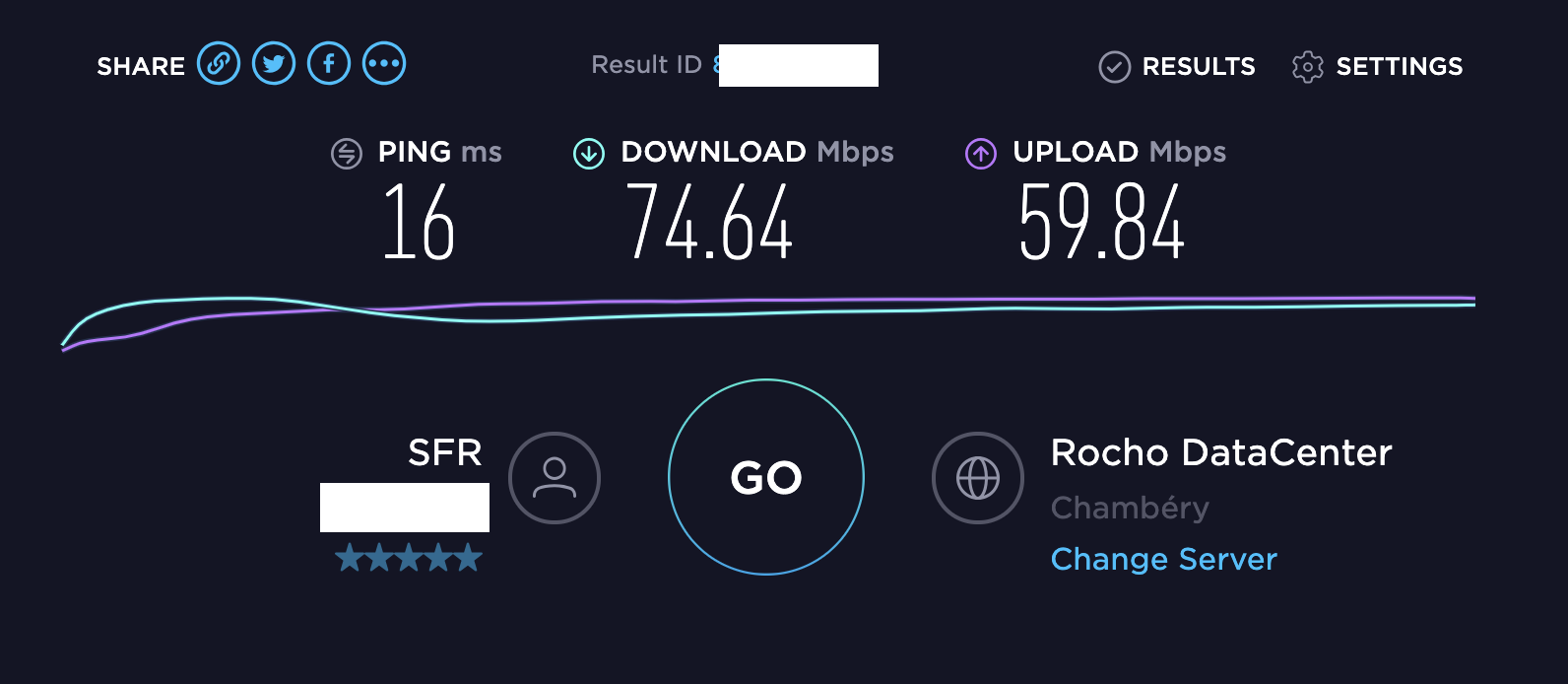

SpeedTest ligne fibre SFR seule:
SpeedTest fibre FingerPrint seule:

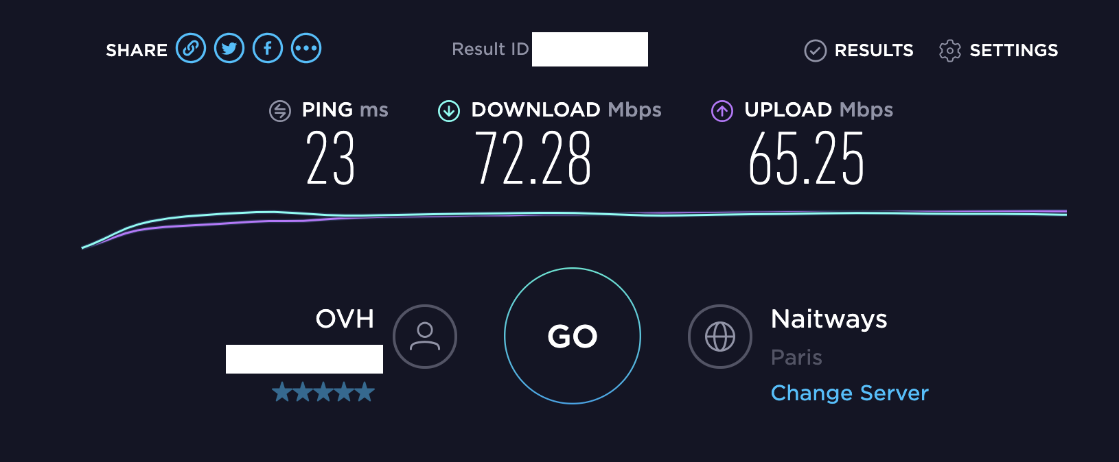

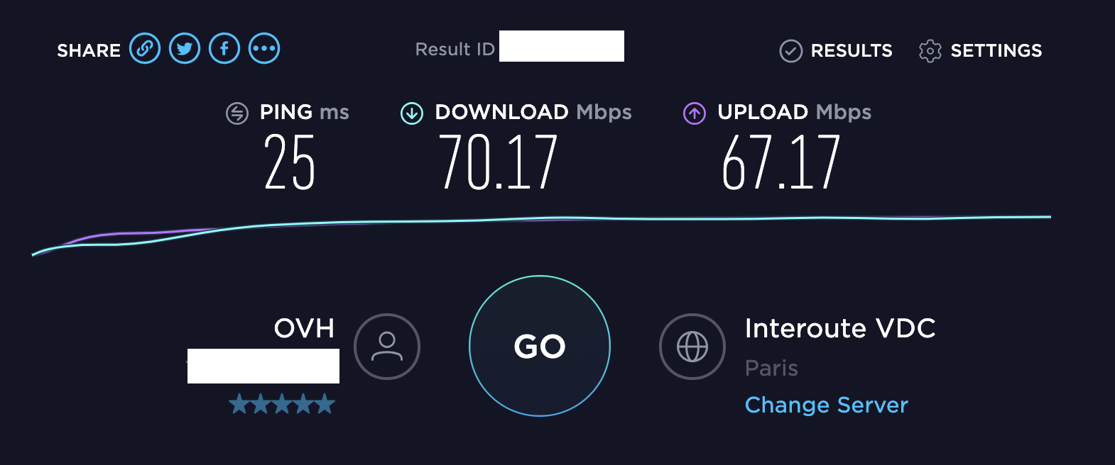

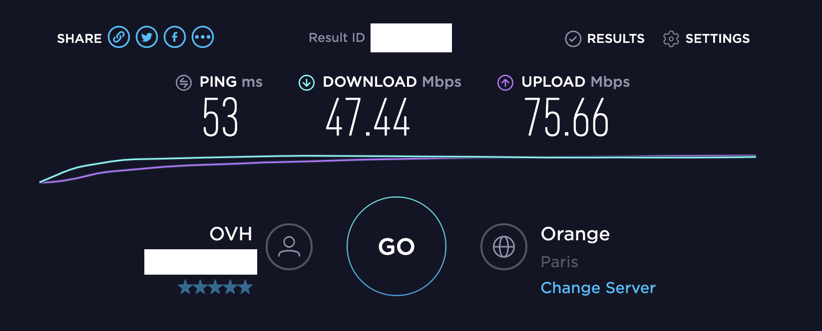

SpeedTest fibre SFR via OTB:
SpeedTest fibre FingerPrint via OTB:

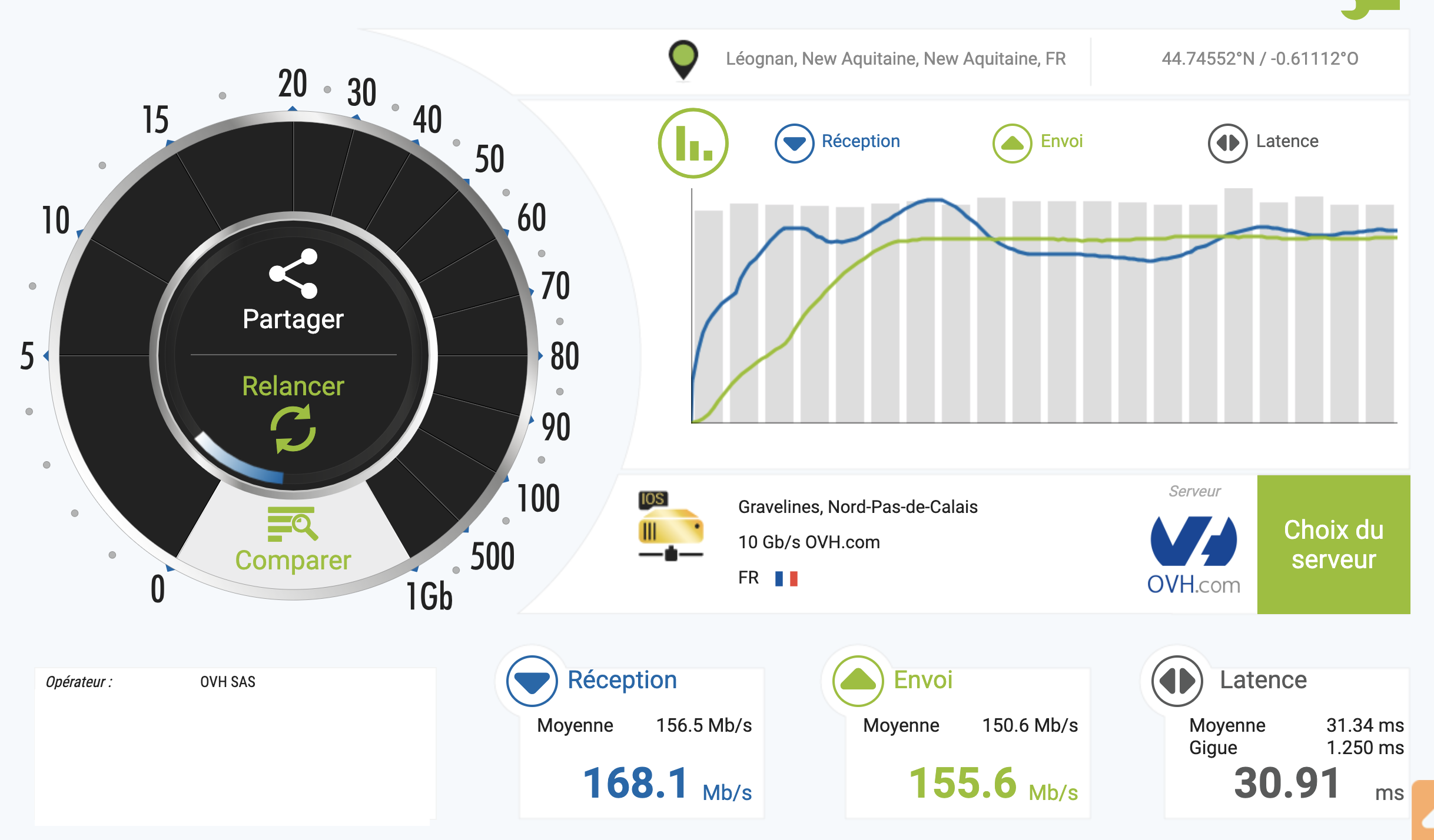

SpeedTest fibre SFR+FingerPrint via OTB:
