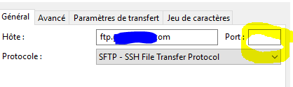

Hello,
Are you sure it's port 22 for the SFTP connection?
Yes I am sure
FileZilla
With FileZilla try do not enter "port"
But on cloudweb ssh/sftp is not on port 22.
Check that in your manager OVH.
