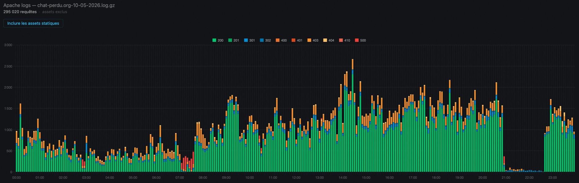

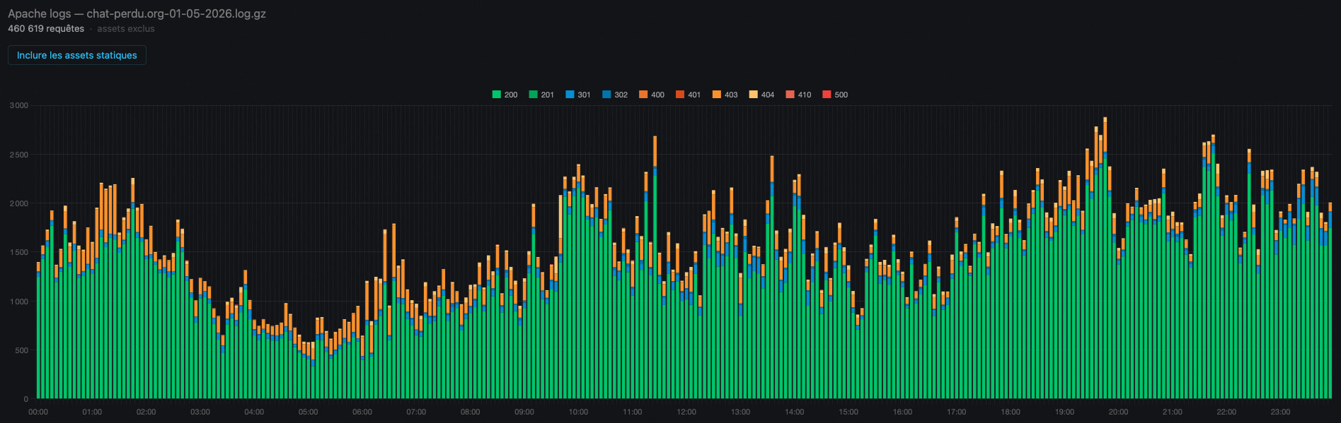

2026-05-01: everything is fine:
2026-05-10: ~2 h of interruption:

@TTY during outage periods, the "access" logs are almost empty (only static resources). However, the "error" logs are full of
AH10141: FastCGI: comm with server "..." aborted: idle timeout (160 sec)
AH10149: FastCGI: incomplete headers (0 bytes) received from server "..."
This does not seem related to traffic: the graphs show that it crashes even during periods when traffic is below the max.
For bots, I have blocked entire IP ranges via .htaccess and also block user‑agents (also via .htaccess) and finally I return a 403 as soon as the request comes from a bot on a page disallowed by robots.txt

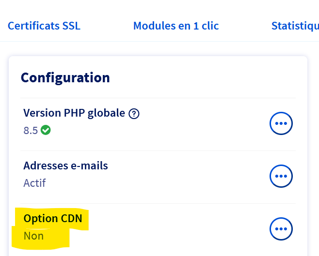

For your info, I changed the DNS records so as not to go through the CDN (that’s the support’s advice to see the source of the error). However, now it’s a "504 Gateway Time-out".

And I suppose that by changing the DNS records, I’ve effectively disabled the CDN.

No @ChristopheM5, you also need to configure it in:
Manager OVH > Web Cloud > Hosting > YourDomain > General information:
