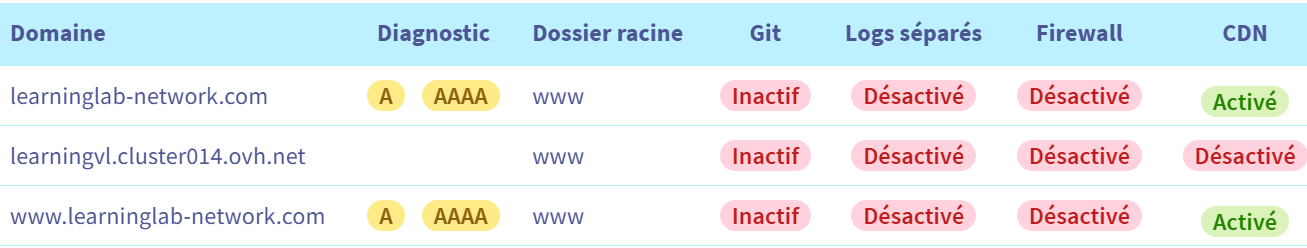

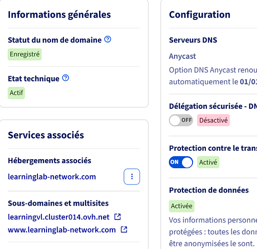

According to your guide, I understand that my site is well hosted elsewhere.
There is a configuration with DNS ns200.anycast.me and dns200.anycast.me
The IPs displayed in my OVH dashboard are indeed those of the visible site.
I don’t see cluster130 or cluster030 anywhere.

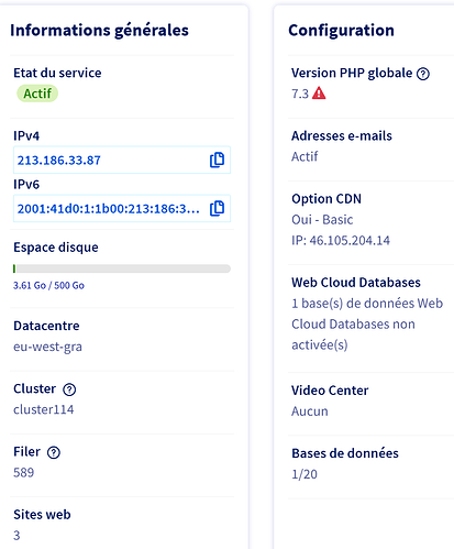

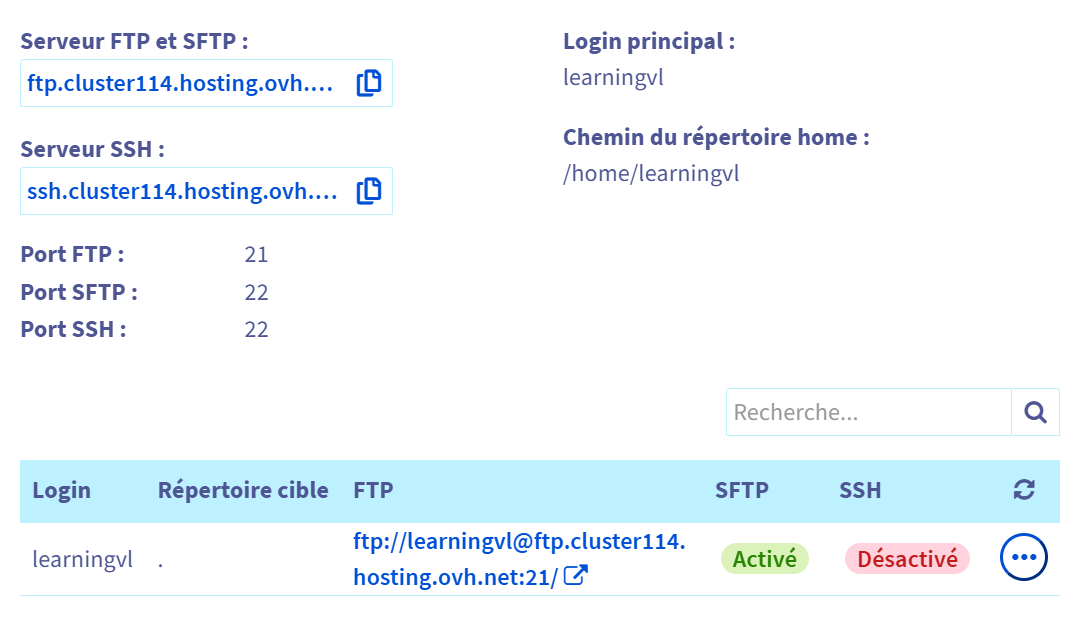

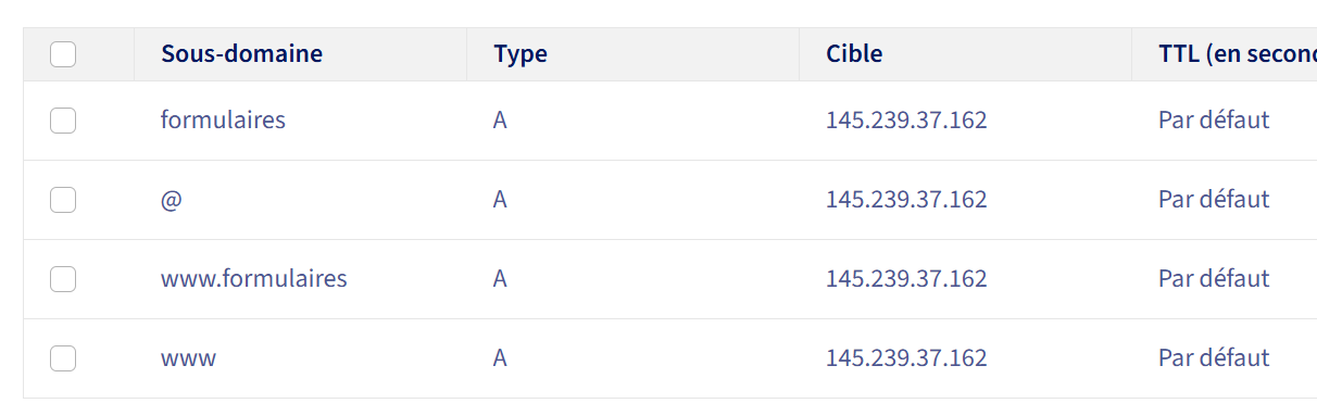

Could you provide us with a screenshot of the entire page with a filter for “A”:
See --> Manager OVH > Web Cloud > Domain > YourDomain > DNS Zone
See --> Manager OVH > Web Cloud > Domain > YourDomain > General Information

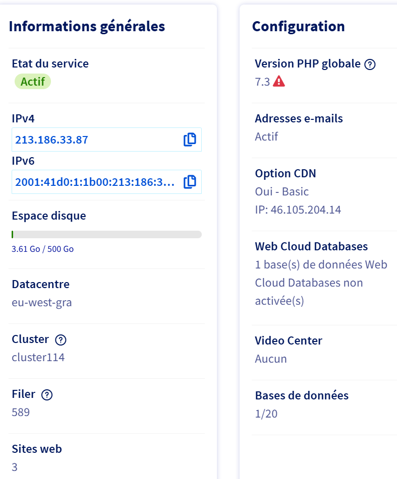

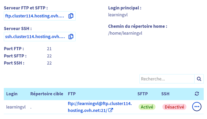

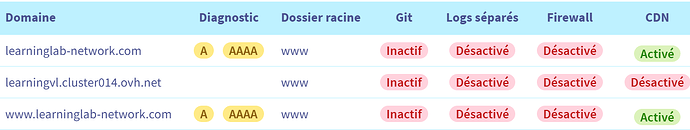

Could you provide us with a screenshot (entire page, including left menu) of:
See --> Manager OVH > Web Cloud > Hosting > YourDomain > General Information
See --> Manager OVH > Web Cloud > Hosting > YourDomain > Multisite
See --> Manager OVH > Web Cloud > Hosting > YourDomain > FTP‑SSH
In the DNS Zone, replace the current addresses with 213.186.33.87
What does that change regarding my problem?
I hadn't seen it. In the DNS zone you need to add the .com
That is: learninglab-network.com
Write the name of your domain in full!
