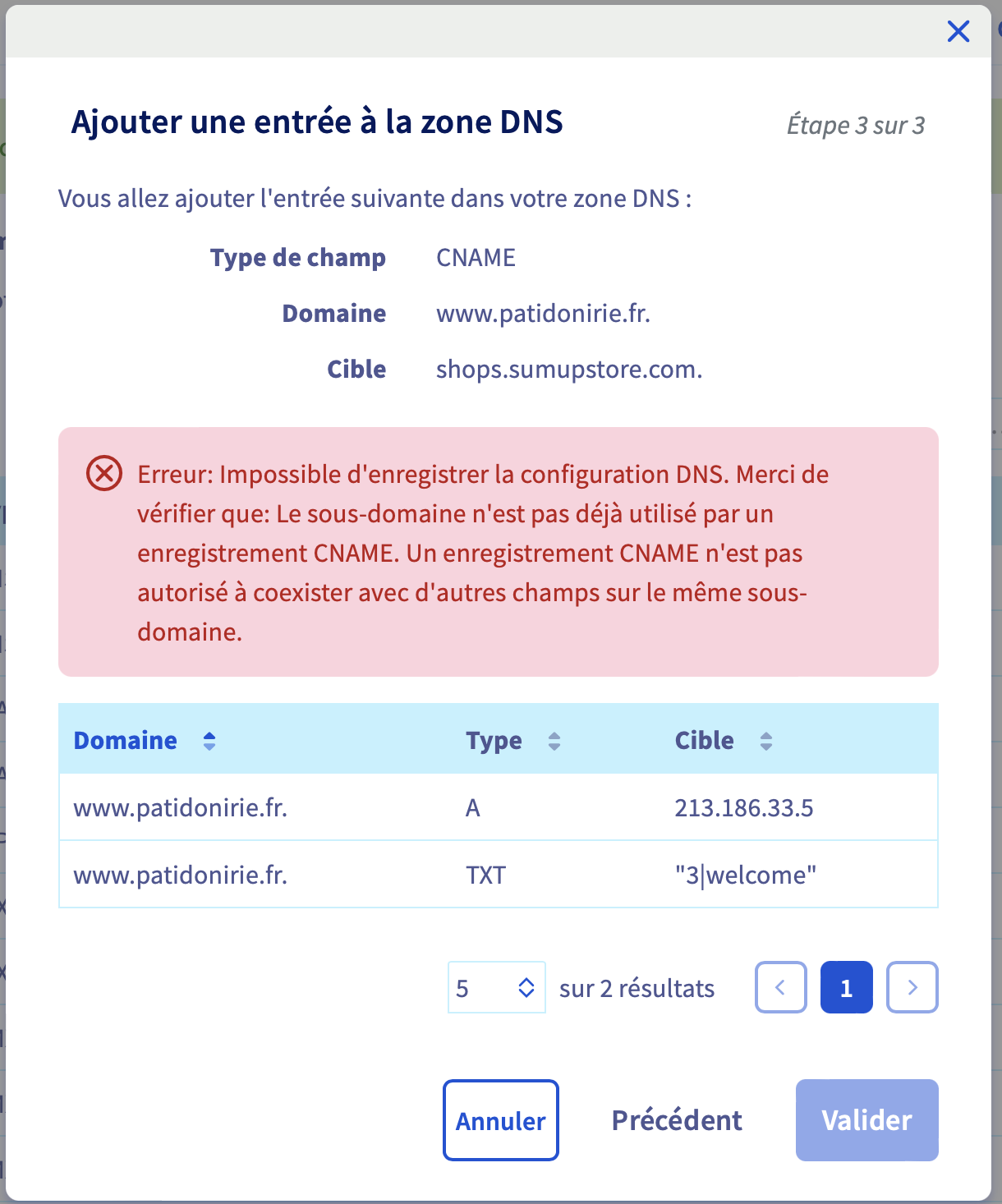

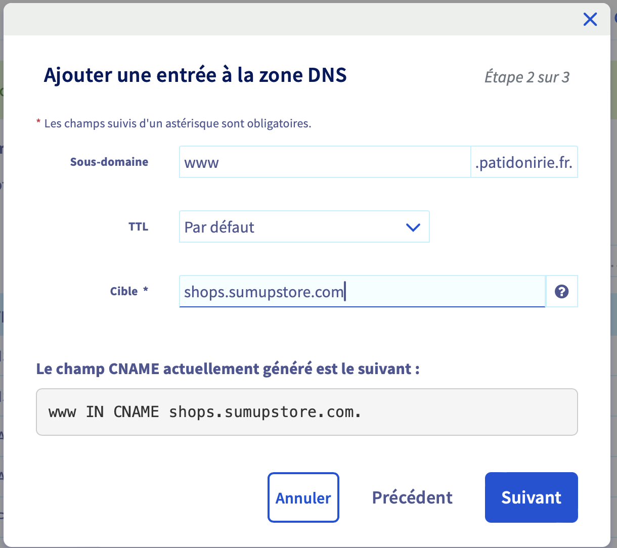

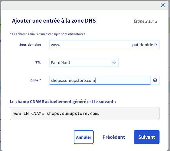

I understood that I need to delete the CNAME entry present in the DNS zone list, and create a new one with the information below:

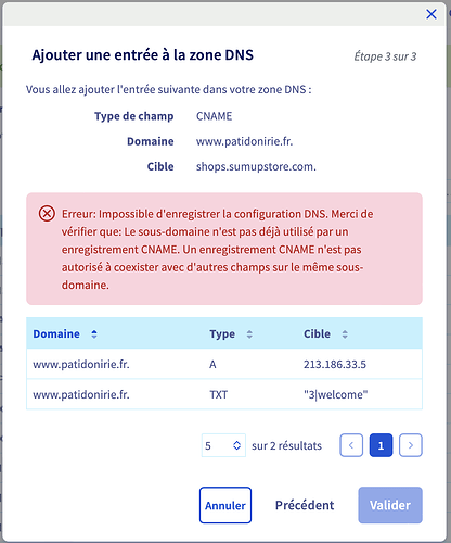

But when I validate, I get this error message:
And I have far too little knowledge about all this, I don’t know what to do.

Hello, I invite you to read my article https://blog.demees.net/cname-ovh-systemeio-shopify-heroku-odoo-wix-monsite/

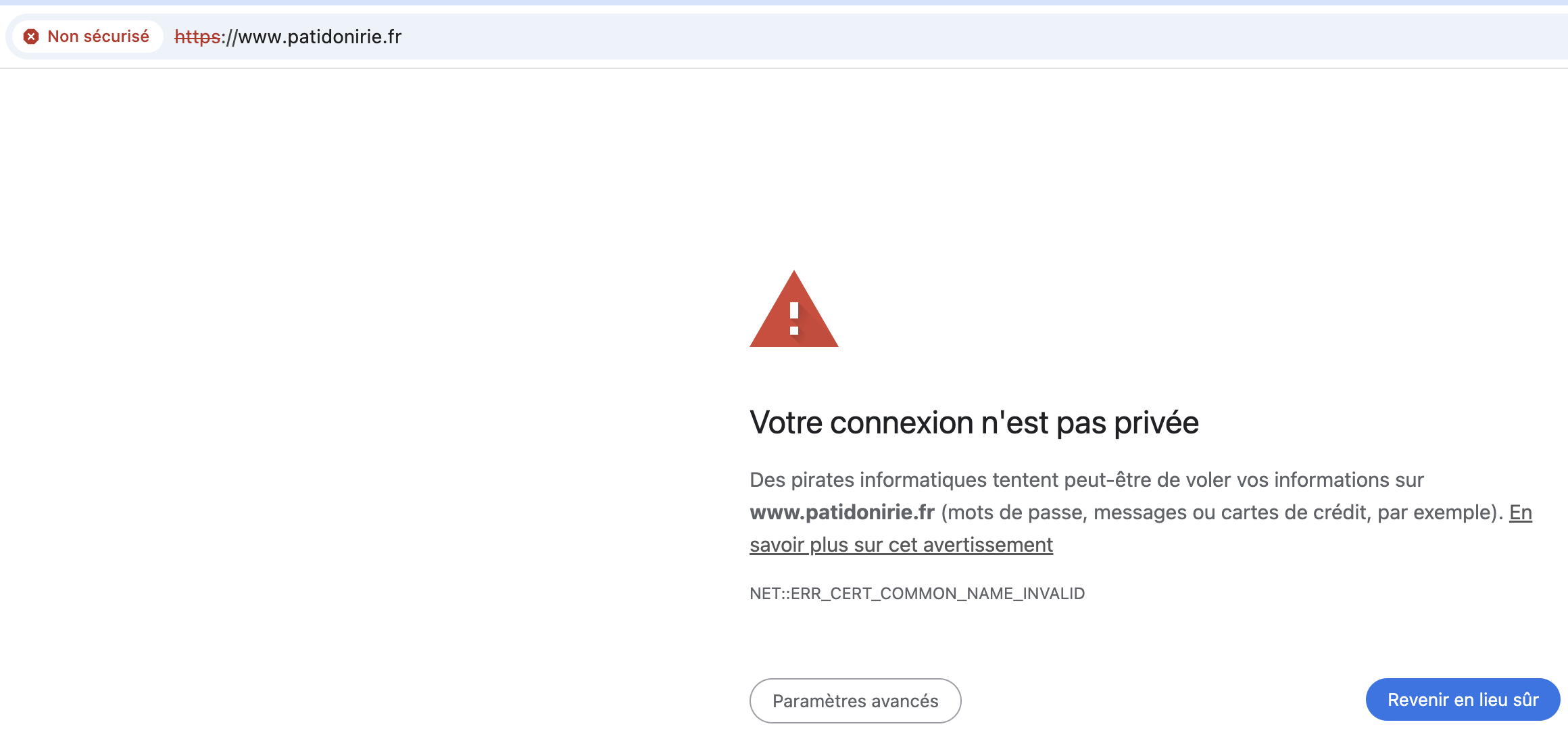

Hi fritz2cat, it looks like it’s working—I just accessed my shop at www.patidonirie.fr, but I get a message saying it’s not secure. What do you think I missed? Anyway, many thanks.
Hello,
Sumupstores had to generate the SSL certificate in the meantime. The error message no longer appears.
Also check with SumUp whether it is normal to be visibly redirected to patricia-eckert-eschenbrenner.sumupstore.com
