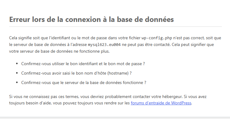

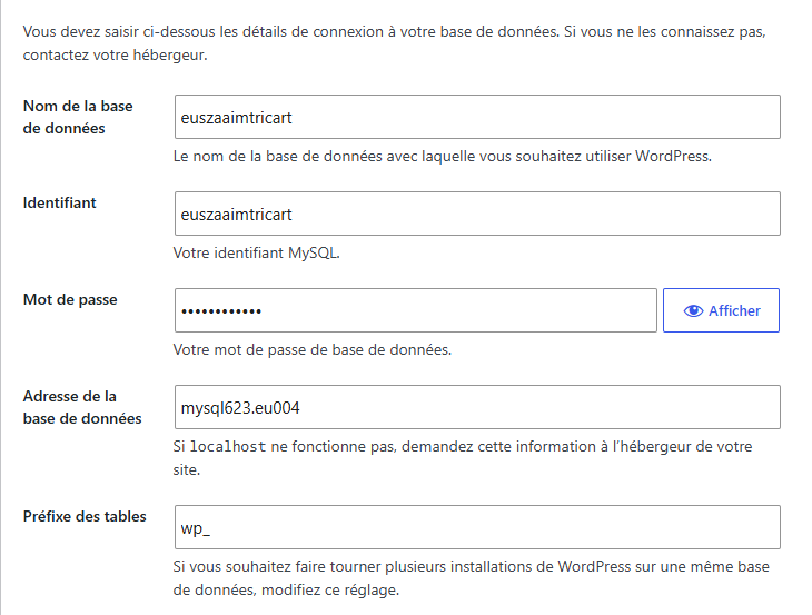

Here's what I did directly in the wp-config-sample.php file, based on my database name on OVH (screenshot below). Why do I still get the Error establishing a database connection error?
Thanks in advance for your help, I'm struggling
// ** Database settings - You can get this info from your web host ** //
/** The name of the database for WordPress */
define( 'DB_NAME', 'euszaaimtricart' );
/** Database username */
define( 'DB_USER', 'euszaaimtricart' );
/** Database password /
define( 'DB_PASSWORD', '
/** Database hostname */
define( 'DB_HOST', 'mysql623.eu004' );
/** Database charset to use in creating database tables. */
define( 'DB_CHARSET', 'utf8mb4' );
/** The database collate type. Don't change this if in doubt. */
define( 'DB_COLLATE', '' );
Hello @Muriel
Error:
It should be:
NomBase.mysql.db
See my guide:
https://wordetweb.com/word-et-web/WORDPRESS-guide-installation-de-WordPress-premier-domaine-chez-OVH-FR.htm#_N2__-

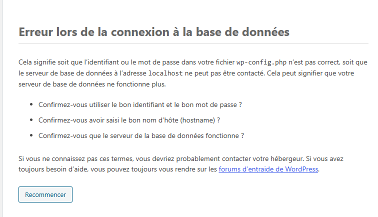

I tried via FileZilla with the wp-config.php file
Here is the response:
I read on the image mysql628.eu004 and not mysql623.eu004

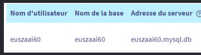

The three pieces of information (except the password) are grouped here. As Asterix indicated, reset the password and you’ll then have the four items needed to identify your database.
That makes me think the wp‑config.php you’re trying to edit isn’t the one your site uses:
Do you have two WordPress installations on your hosting?
I’ve got these four items,

Hello
Probably because you aren't providing the requested information correctly.
You must use the three pieces of information given by @fritz2cat plus the password
Your wp-config.php should be filled out like this.
Damn, it’s good, the database is recognized when I go through FileZilla, I changed the config file again.
I think I got the host name and user mixed up.
