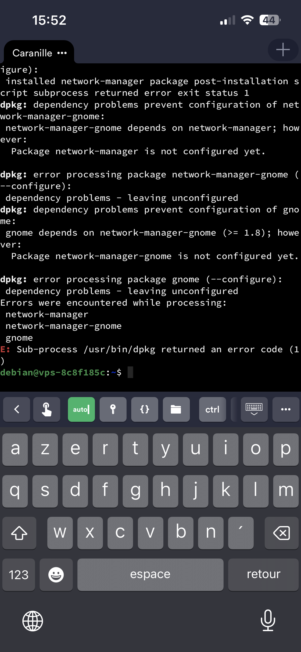

Lorsque je souhaite installer gnome ou kde via apt j'ai cette erreur
installed network-manager package post-installation s cript subprocess returned error exit status 1 dpkg: dependency problems prevent configuration of net work-manager-gnome:
network-manager-gnome depends on network-manager; how ever:
Package network-manager is not configured yet.
dpkg: error processing package network-manager-gnome (
-configure):
dependency problems - leaving unconfigured dpkg: dependency problems prevent configuration of gno me:
gnome depends on network-manager-gnome (>= 1.8); howe ver:
Package network-manager-gnome is not configured yet.
dpkg: error processing package gnome (–configure):
Errors were encountered while processing:
network-manager network-manager-gnome gnome
E: Sub-process /us/bin/dpkg returned an error code (1
debian@vps-8c8f185c:~$
