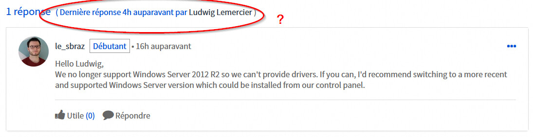

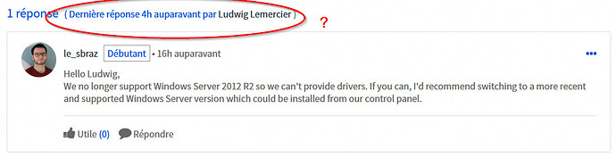

Hello Ludwig,
We no longer support Windows Server 2012 R2 so we can't provide drivers. If you can, I'd recommend switching to a more recent and supported Windows Server version which could be installed from our control panel.
