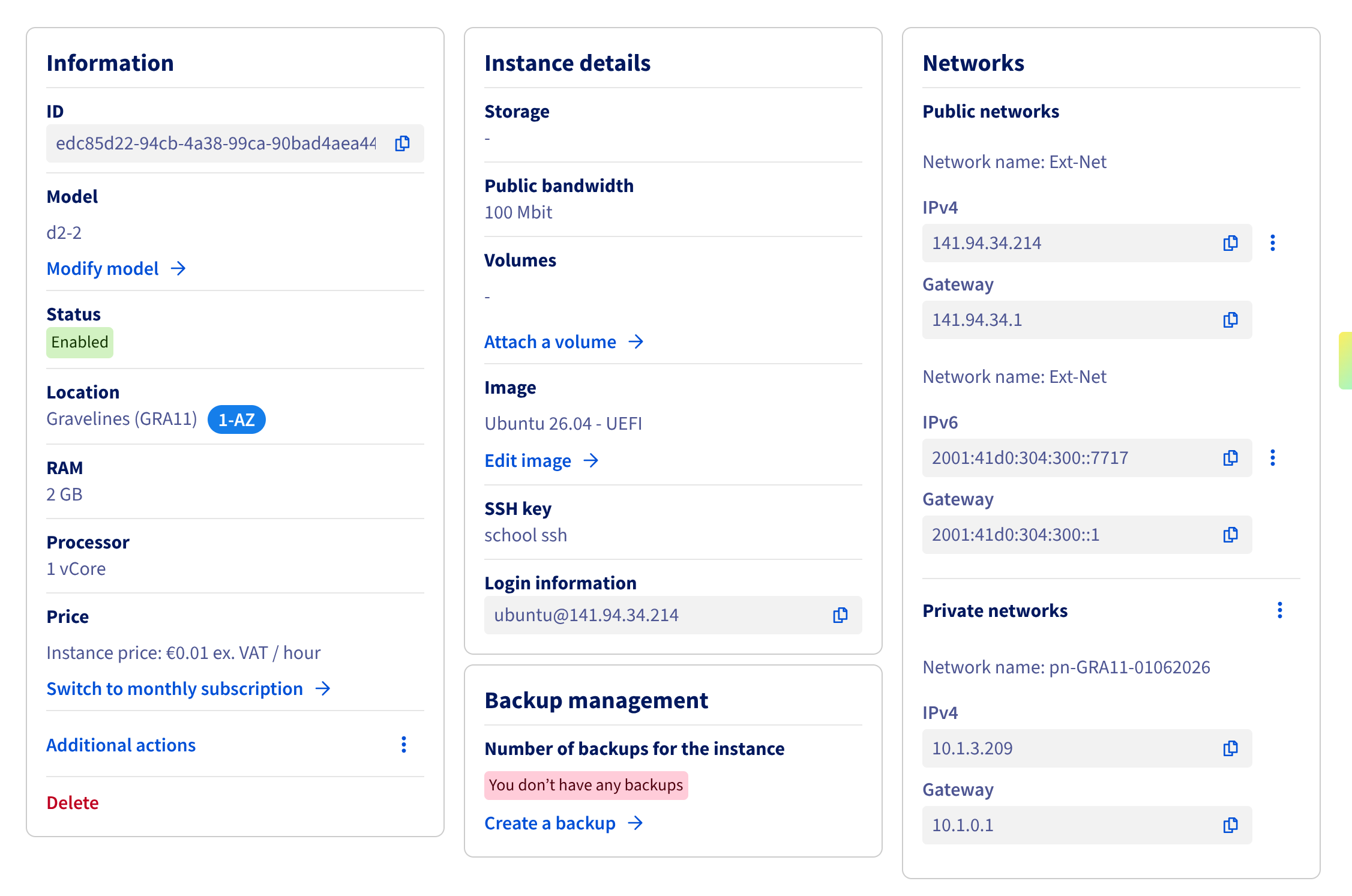

Yes, I have a public IP, here’s the information page for my server
It appears there is indeed a blockage:

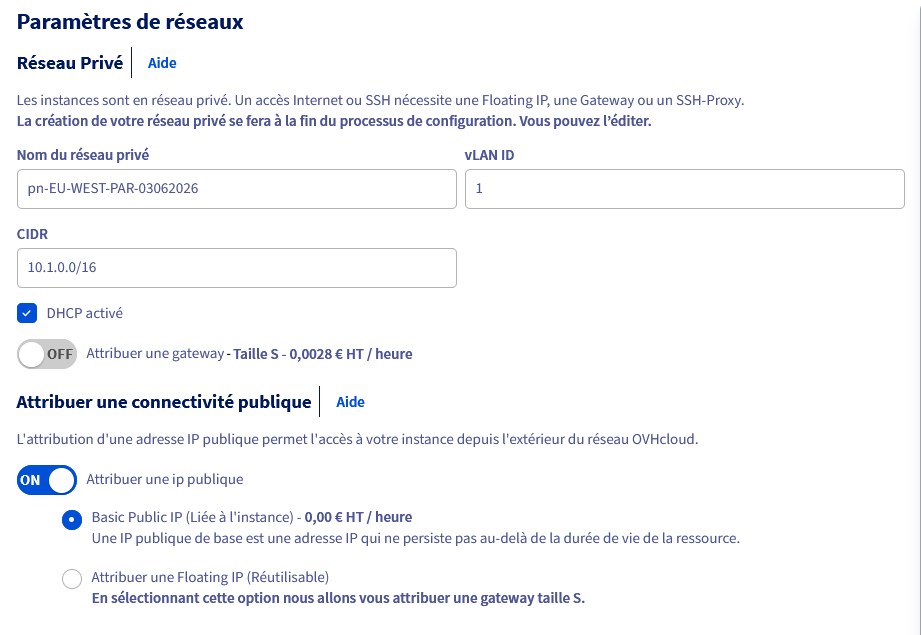

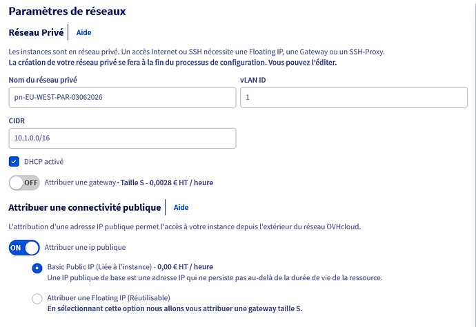

Everything works, I had to, when configuring my machine, specify that I want to have my own private network.
A big thank you to both of you for all the clarifications :slight_smile:
Thanks, that was it, I had to create my own private network so I wouldn't have a gateway (I don’t know what that is, but I think I should have configured it).
Everything works now :slight_smile:
