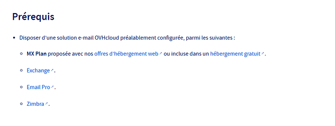

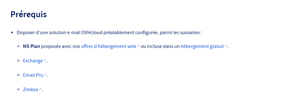

I have found this:
https://help.ovhcloud.com/csm/fr-ca-mx-plan-email-redirection?id=kb_article_view&sysparm_article=KB0052036
In that guide, under the “Create an alias” section, it states that you can add aliases both from an MX Plan service and from Exchange or Email Pro. The process is similar: you go to the “Email accounts” tab, look for the “Alias” column and add the address you want to act as a mask.
Let me know :blush:
Sergio Turpín
Yes, I have the “MX Plan Roundcube” version, for which it is specified “To create an alias on an MX Plan Roundcube email account, you must do it the same way as a forward.” I don’t have the ability to create aliases. I’ll see if I can switch to a recent MX Plan offering.

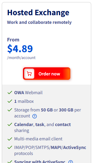

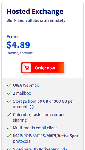

Hello, yes, it is confirmed in the official OVH documentation. The migration to Zimbra affects exclusively the MX Plan, not the professional solutions.
You can see it in this OVH status notice: it states that the migration is to “migrate the MXPLAN accounts under Outlook Web Access (OWA) to Zimbra”.
https://www.ovhcloud.com/en/emails-exchange/#main-content
And on the product pages for Email Pro and Hosted Exchange, the webmail remains Outlook Web Access (OWA) as clearly specified. Therefore, if you migrate to one of these offers, OWA stays unchanged.
I might be wrong…
Best regards,
Sergio Turpín
Today you can no longer order a Mail Pro account that runs on Microsoft OWA. Zimbra is automatically offered.
However, Exchange (hosted or private) remains Exchange, and it is necessarily Microsoft. We’re talking about something else and it’s at a different price.
