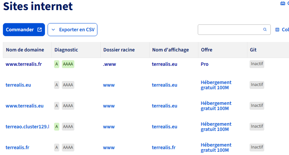

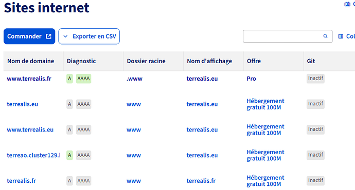

Send us a screenshot of what you have in your OVH “Multisite” space.
Hello
I just sent the screenshot
Thanks
To be clearer.
I want my website to be linked to the domain name: terrealis.fr
And I have taken a Pro WordPress plan with the domain name: terrealis.eu and I tried to “merge” them and it seems that the SSL certificate is not activated.
Thanks in advance
For terrealis .fr and www.terrealis.fr you need to remove the dot before the www you should use only www

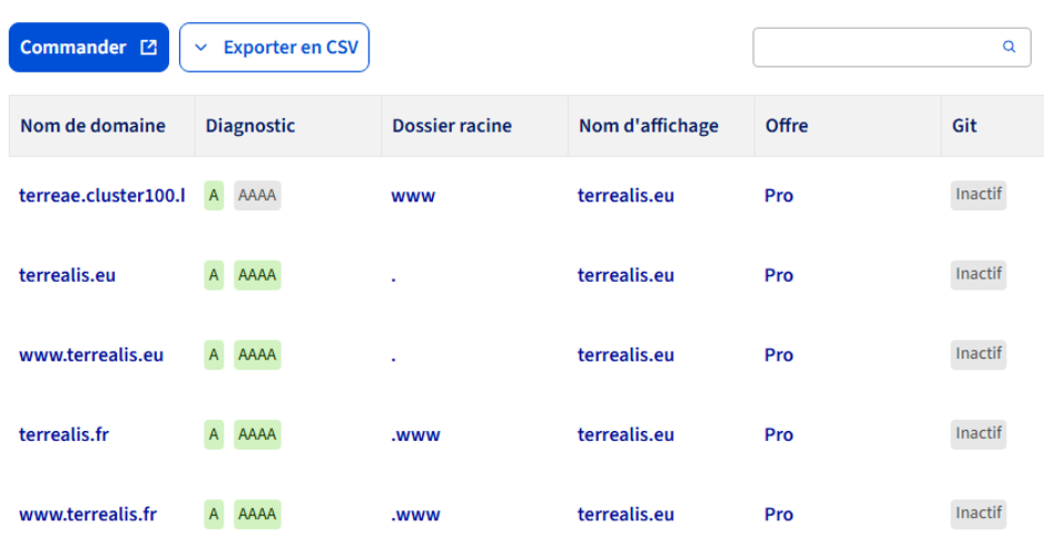

Hi @admin6362
What I see when entering your domain:
The next step is very simple and is done in the client area:
  1. Go to the Multisite tab of your hosting.
  2. Find the entry for terrealis.fr.
  3. Click the ... button on the right and select Modify domain.
  4. In the window that opens, change the “Root folder” field
    • Replace the current . with the folder where your site’s files are. According to your screenshots, that folder is www
  5. Repeat exactly the same process for terrealis.eu, and for www.terrealis.fr and www.terrealis.eu
By doing this, when someone accesses terrealis.fr, the server will look for the files inside the www folder instead of the root.

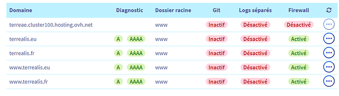

That’s done and it worked, thank you
However, on the page below I still see the notice on my root folder: no valid confirmation was found in the DNS zone. To resolve the issue, add an AAAA record with the IPv6 address.
I don’t know how to do that.
And another matter, in my site’s toolbar: it says I’m not on https. How can I add SSL?
