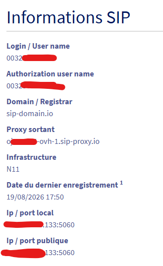

this is the configuration that OVH gives me unfortunately with this new N11 infra:
SIP account:
Login / User name : 0033xxxx
Password : appropriate password
Authorization user name : 0033xxxx
Domain / Registrar : sip-domain.io
Outbound proxy : sh249261-ovh-1.sip-proxy.io

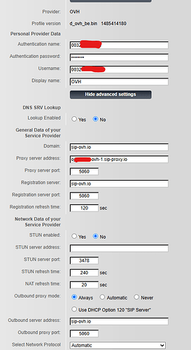

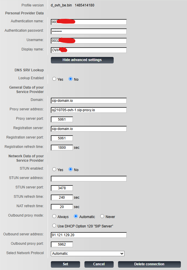

Same problem on a Gigaset 530 IP (up to date)
With the domain sip-domain.io it cannot connect via SIP.
On a Fritzbox 7590 it works perfectly.
I have already tried every setting available in my OVH client interface. OVH also refuses to give me any help on this.
because: “not purchased from us” :partying_face:
But it is stated in their documentation! It’s just that the information is outdated!
Is there a solution to this problem or should I toss the Siemens Gigaset 530 IP?

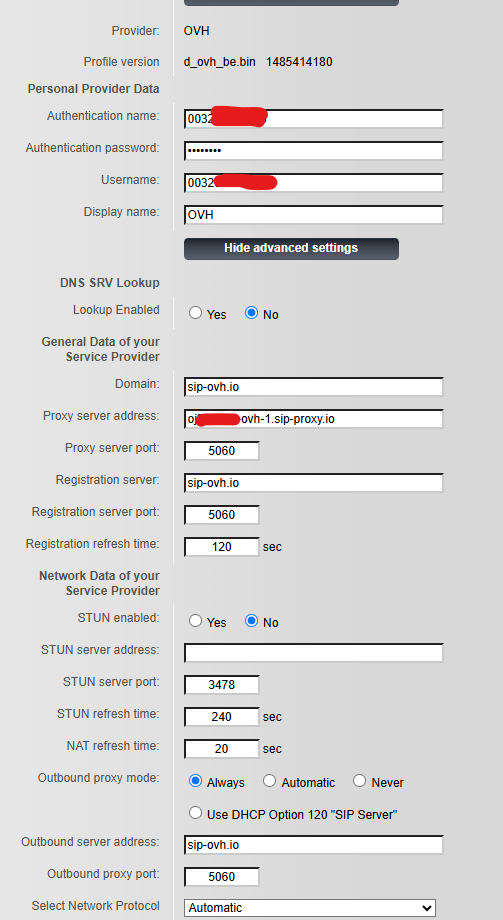

I have a doubt about the use of “always” of the proxy “sip-ovh.io”.

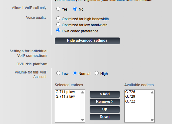

Were the codecs authorized? G.711 law A at a minimum (we can authorize all of them, it doesn't hurt).
We see that the registration succeeded, so what is not working?
Yes, it's a fake screenshot, I'm still using sip-domain.io
