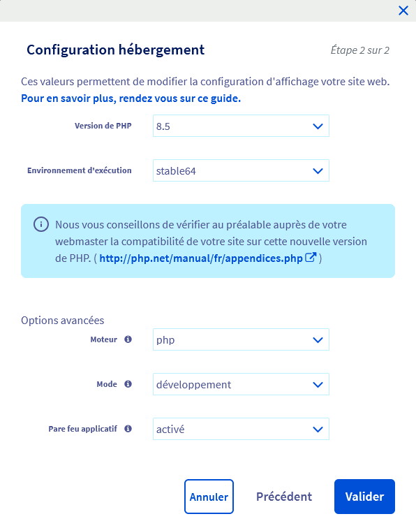

Hello @Moiettoi
Switch to the Development environment to see the cause of the 500 Error
See the paragraph in my guide: P2 - Erreur 500 - Environnement développement

I’ve enabled development mode and, apart from the following random 500 error, I don’t see anything else; in fact, I don’t see what putting the site into development mode achieves beyond bypassing OVH’s cache.

Hello @Moiettoi
I’m a bit surprised.
I regularly use development mode when there’s a 500 error.
I don’t know about you whether you have actually enabled this development mode, but normally the 500 error should no longer appear as such, but rather the cause of the error.
Yes, I also used Development mode and, a priori, you shouldn’t see that Error 500, but the reason behind it. How did you enable it?
So, we’re talking about the same thing, right?
When I disable all modules, there is no longer a 500 error ... the historic personal hosting really can’t keep up with modern sites. I’ll test the professional plan, but I think OVH leaves only very few resources on the personal offer for static HTML sites from the early 2000s...
