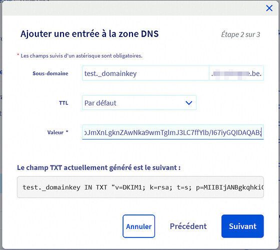

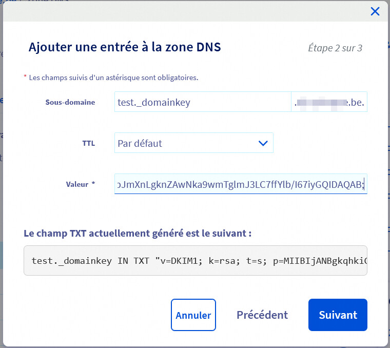

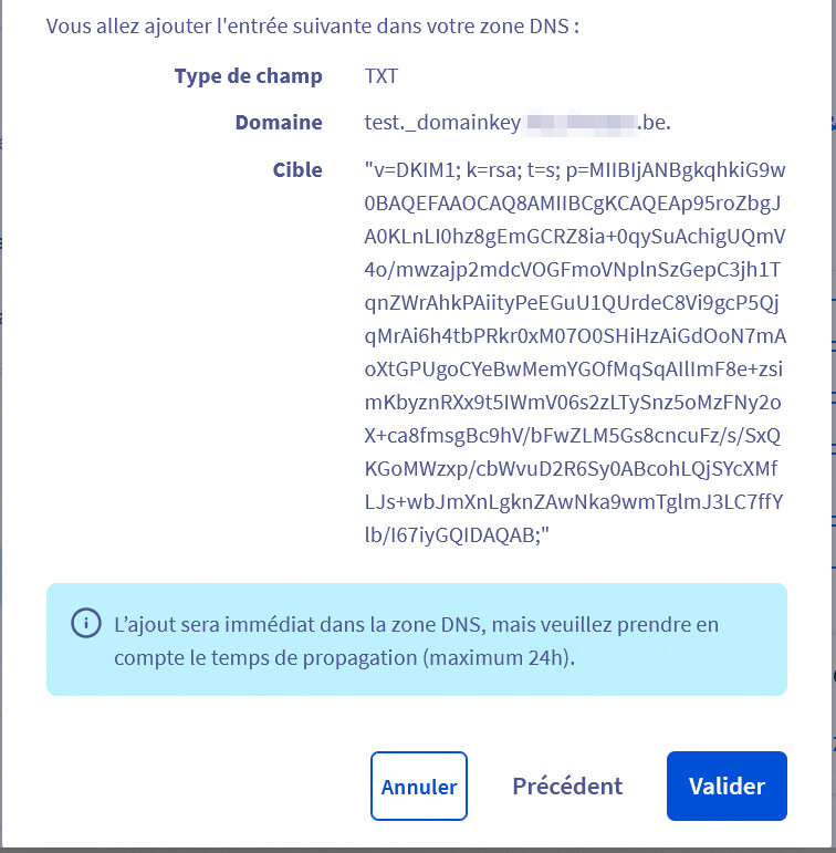

En images:
J'ajoute un champ TXT
puis
et la résultat est bien là
~# dig test._domainkey****.be txt
; <<>> DiG 9.18.33-1~deb12u2-Debian <<>> test._domainkey.*****.be txt
;; global options: +cmd
;; Got answer:
;; ->>HEADER<<- opcode: QUERY, status: NOERROR, id: 28210
;; flags: qr rd ra; QUERY: 1, ANSWER: 1, AUTHORITY: 0, ADDITIONAL: 1
;; OPT PSEUDOSECTION:
; EDNS: version: 0, flags:; udp: 1232
;; QUESTION SECTION:
;test._domainkey.*******.be. IN TXT
;; ANSWER SECTION:
test._domainkey.*****.be. 86400 IN TXT "v=DKIM1; k=rsa; t=s; p=MIIBIjANBgkqhkiG9w0BAQEFAAOCAQ8AMIIBCgKCAQEAp95roZbgJA0KLnLI0hz8gEmGCRZ8ia+0qySuAchigUQmV4o/mwzajp2mdcVOGFmoVNplnSzGepC3jh1TqnZWrAhkPAiityPeEGuU1QUrdeC8Vi9gcP5QjqMrAi6h4tbPRkr0xM07O0SHiHzAiGdOoN7mAoXtGPUgoCYeBwMemYGOfMqSqAIlImF8e+zs" "imKbyznRXx9t5IWmV06s2zLTySnz5oMzFNy2oX+ca8fmsgBc9hV/bFwZLM5Gs8cncuFz/s/SxQKGoMWzxp/cbWvuD2R6Sy0ABcohLQjSYcXMfLJs+wbJmXnLgknZAwNka9wmTglmJ3LC7ffYlb/I67iyGQIDAQAB;"
Ta clé DKIM est bien là
