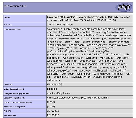

Here is an excerpt of PHPINFO.php
Thank you in advance,
What interests me: it's the output of my script.
Example for: https://wordetweb.com/word-et-web/bonjour.php
Hello. - It is 2026-07-07 16:45:15
PHP version: **8.5.0**

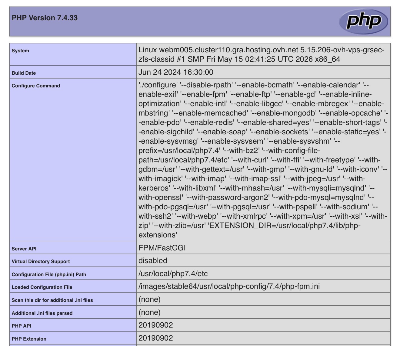

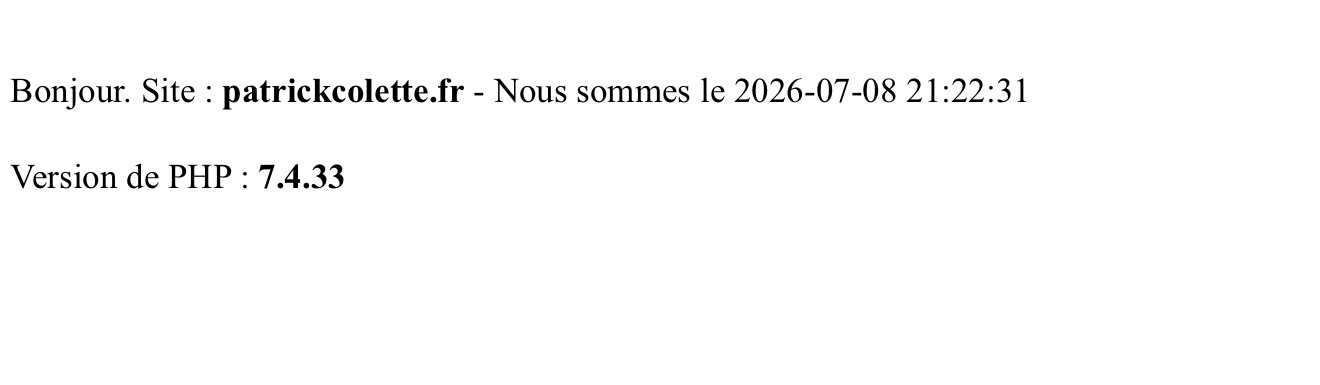

Hello Gaston,
Here is the result of bonjour.php

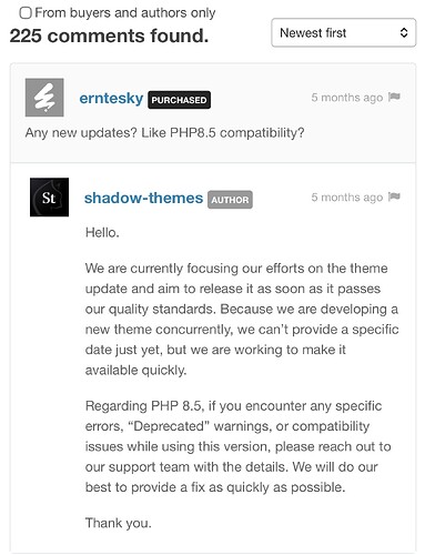

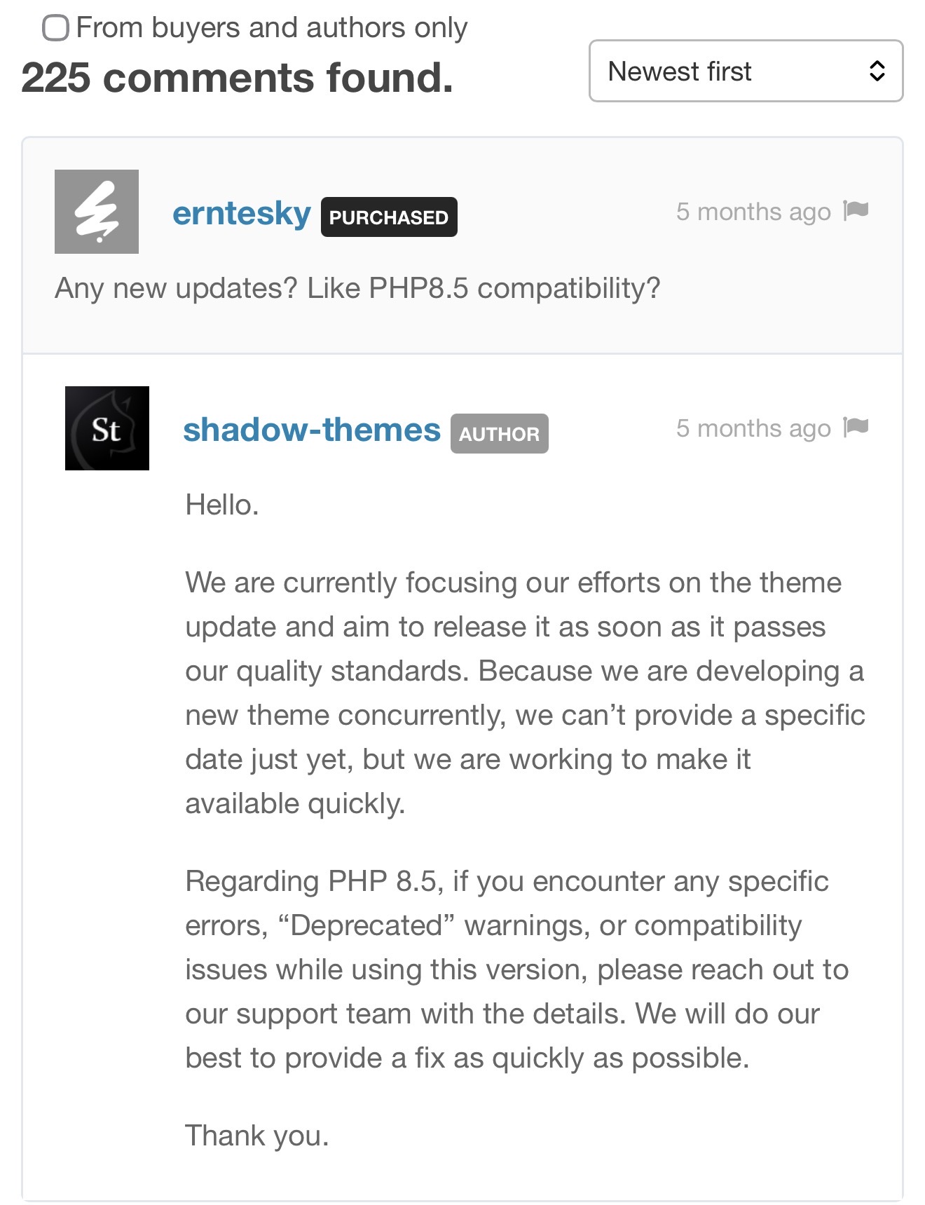

I noticed that in the comments of the theme creator I’m using, there’s a comment without the “support” section that relates to the PHP 8.5 topic,
So I sent a message to the web designer requesting an update,
I think this is due to the PHP version of the theme being used
Here is the post,
I’m waiting for the web designer’s response..

In response to my question, I got an answer from the theme’s web designer who told me that their demo is on version 8.5.6

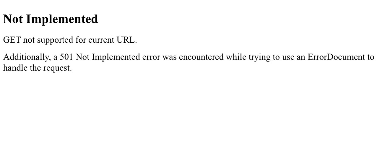

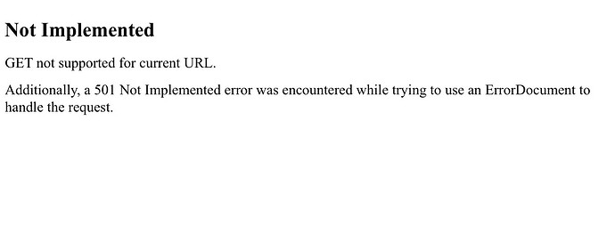

Here’s what happens when I remove the .ovhconfig file from the root

Hello,
Leave a SINGLE .ovhconfig in your hosting. This one could be generated when you go to your client area, hosting section and choose the execution environment.
Alternatively, if you have multiple sites in your multisite, and they require different PHP versions from each other, you can place a .ovhconfig in the main folder of each sub‑site, and in that case you must not place a .ovhconfig in the root of your hosting.
The error message you have: “GET not implemented” occurs when the wrong value “stable” is used instead of “stable64” or vice‑versa in the .ovhconfig file. You must use “stable” up to php7.3 and “stable64” from php7.4.
