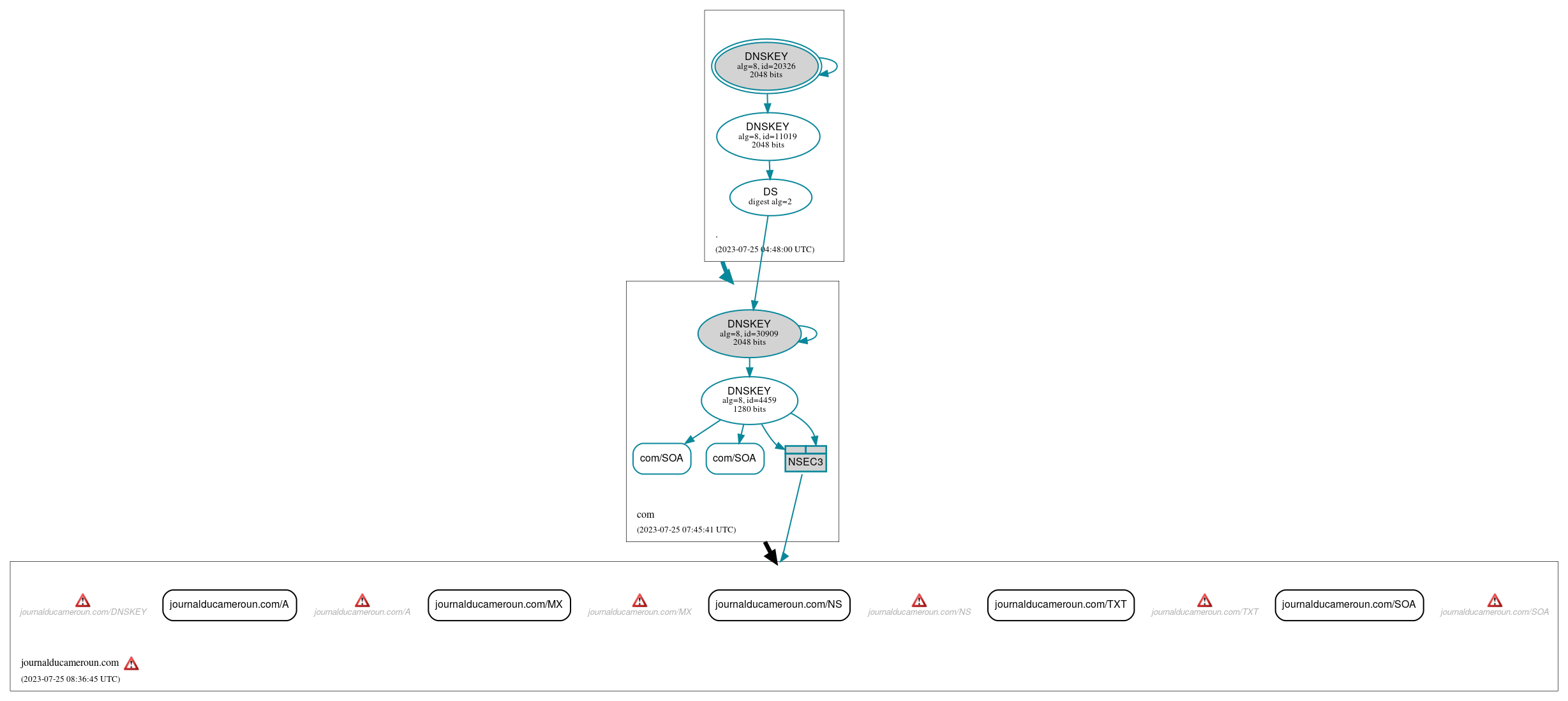

Cependant en analysant le nom de domaine racine a l aide du service https://intodns.com/
nous avons constaté les erreurs qui sont décrites dans la capture que je joint à cette publication.
Nous pensons donc qu'il y a un souci mais ne savons pas comment le résoudre.
Que devons-nous faire donc pour résoudre ce problème ?
Toute proposition de solution sera la bienvenue.
Merci d'avance
-------ERREUR RENCONTREE-------
journalducameroun.com zone: The server(s) responded over TCP with a malformed response or with an invalid RCODE. (2001:41d0:3:163::1)
journalducameroun.com zone: The server(s) responded over UDP with a malformed response or with an invalid RCODE. (2001:41d0:3:163::1)
journalducameroun.com zone: The server(s) were not responsive to queries over UDP. (213.186.33.99)
journalducameroun.com/A: No response was received from the server over UDP (tried 12 times). (213.186.33.99, UDP_-NOEDNS)
journalducameroun.com/A: The response had an invalid RCODE (REFUSED). (2001:41d0:3:163::1, UDP_-EDNS0_4096_D_KN)
journalducameroun.com/DNSKEY: The response had an invalid RCODE (REFUSED). (2001:41d0:3:163::1, UDP
-EDNS0_4096_D_KN, UDP-EDNS0_512_D_KN)
journalducameroun.com/MX: The response had an invalid RCODE (REFUSED). (2001:41d0:3:163::1, UDP
journalducameroun.com/NS: No response was received from the server over UDP (tried 12 times). (213.186.33.99, UDP
-NOEDNS)
journalducameroun.com/NS: The response had an invalid RCODE (REFUSED). (2001:41d0:3:163::1, UDP_-EDNS0_4096_D_KN)
journalducameroun.com/SOA: The response had an invalid RCODE (REFUSED). (2001:41d0:3:163::1, TCP
-EDNS0_4096_D_N)
journalducameroun.com/SOA: The response had an invalid RCODE (REFUSED). (2001:41d0:3:163::1, UDP
-EDNS0_4096_D_KN, UDP-EDNS0_4096_D_KN_0x20)
journalducameroun.com/TXT: The response had an invalid RCODE (REFUSED). (2001:41d0:3:163::1, UDP
-_EDNS0_4096_D_KN)
