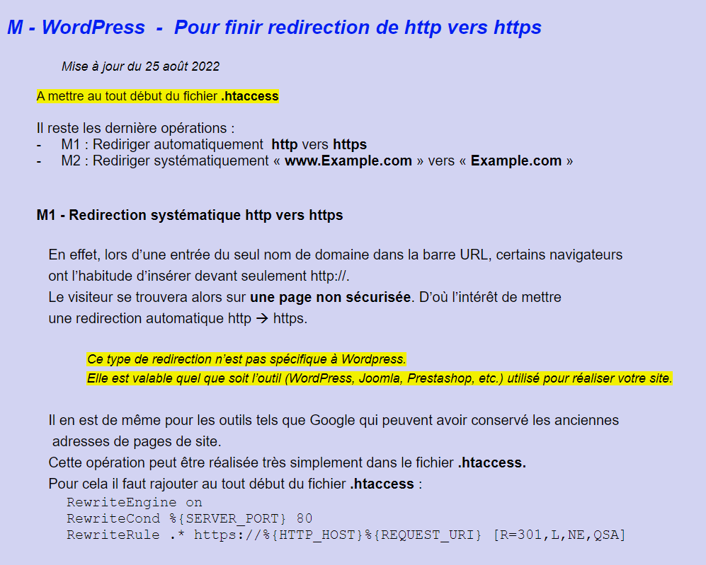

Hum! Hum! –> M - WordPress - Pour finir redirection de http vers https
https://www.wordetweb.com/word-et-web/WORDPRESS-guide-installation-de-WordPress-premier-domaine-chez-OVH-FR.htm#M-_WordPress
