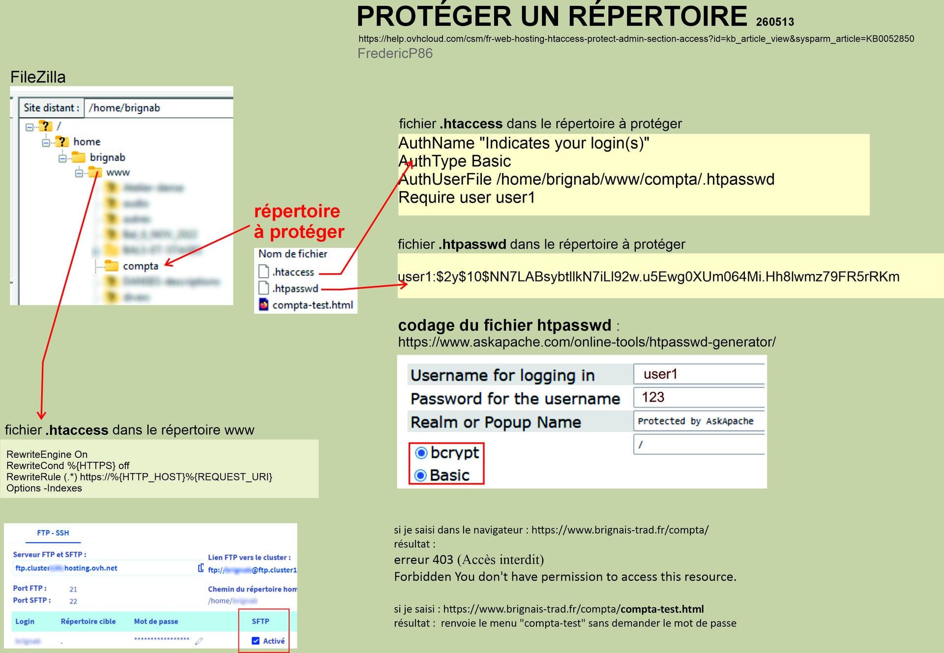

Pour le moment, j'en suis là (voir pièce jointe),
j'ai effectivement une erreur de mot de passe non reconnu.

Je mets en pièce jointe un récapitulatif de la procédure que j'ai utilisée,
au cas ou ça peut servir.

Hello,
I'm still trying to protect a directory and so far nothing works.
If I enter in the browser: https://www.brignais-trad.fr/compta/
Result: error 403 (Forbidden)
Forbidden You don't have permission to access this resource.
If I enter in the browser: https://www.brignais-trad.fr/compta/compta-test.html
Result: returns the "compta-test" menu without asking for the password.
Hello @FredericP86
That's normal if you don't have an index file in the /compta/ directory.
That's normal as well, you already gave it; as long as you haven't closed the browser it won't ask you for it each time you open a page.
Close your browser, reopen it and go directly to https://www.brignais-trad.fr/compta/compta-test.html; it should this time ask you for the password to open the page.
I didn't know that an "index" file was required in this directory; perhaps that should be specified in the OVH tutorial.
Indeed, now it works.
A big thank you to you.
That's not an OVH peculiarity but a web rule we are supposed to know. :grinning_face_with_smiling_eyes:
If you want to put a few pages there, you'll need at least a home page called index.html and then you can open the directory from that index page by just specifying https://www.brignais-trad.fr/compta/
