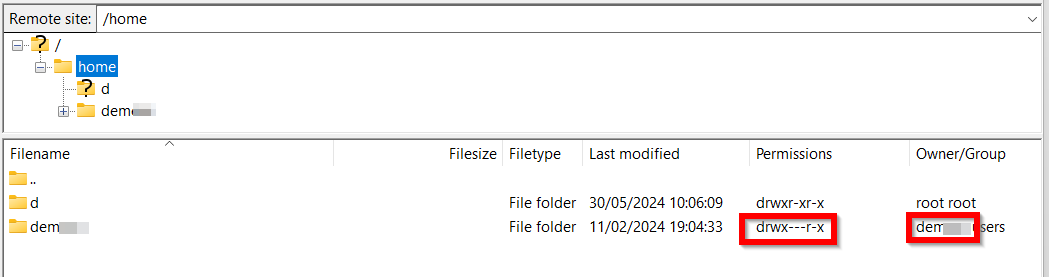

Votre répertoire racine (/home) doit avoir les permissions suivantes: "drwx---r-x"
Voici avec Filezilla connecté en mode SFTP.
Voyez (1) les permissions et (2) le owner qui doit être votre login FTP.

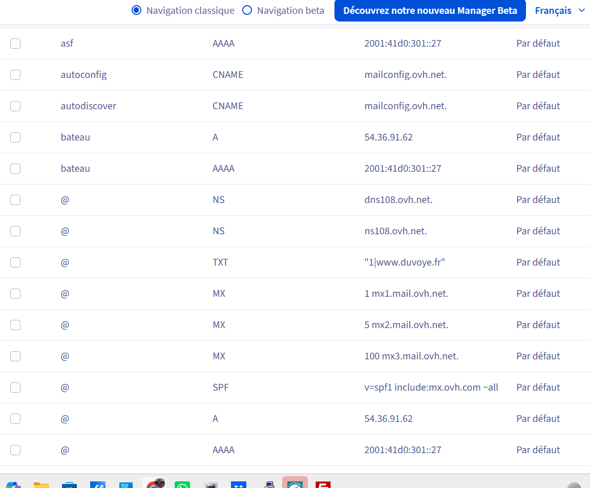

I had a VPS. And I want to terminate it........ and as a result I had many redirects and sub‑domains... Some appeared automatically.
I would like to clean that up.... Can you help me?
other sites:
What are the other redirects for?

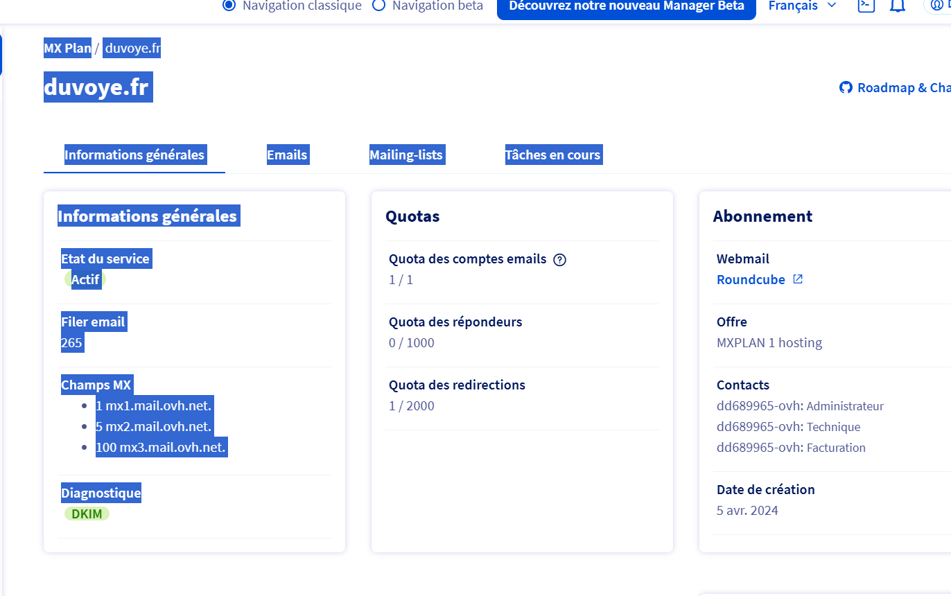

On some sites there is a contact page: webmaster@duvoye.fr that worked with the VPS. I want it to work now with the web‑hosting....... but I can’t configure it: response: your mail plan is already used elsewhere ...; so I need to remove everything related to the VPS that I’m no longer using
I don’t even know what all this is for......;
Likewise I have www.asf.duvoye.fr and asf.duvoye.fr.......is it worth keeping www.duvoye.fr and duvoye.fr....
Lots of questions

But what should I do with all the other redirects associated with my domain duvoye.fr?
Things like MX, CNAME, etc., I have three pages....... it seems like a lot for these simple four sites which, if I understand correctly, would only need eight A and AAAA entries for IPv4 and IPv6:
- asf.duvoye.fr and www.asf.duvoye.fr
- bateau.duvoye.fr and www.bateau.duvoye.fr
- mathsf.duvoye.fr and www.maths.duvoye.fr
- ratafia.duvoye.fr and www.ratafia.duvoye.fr
What should I do with the others?
- duvoye.fr and www.duvoye.fr which shouldn’t point anywhere, for example
The others don’t appear in 'multisite', but in the DNS zones of my domain....
Similarly, I just saw that the email address webmaster@duvoye.fr is in the 'Email' tab and not in 'multisite'... maybe that’s why I can’t set it up in multisite......
Removing all these redirects in the domain won’t it also remove them from multisite?
Then, since I’m shutting down the VPS, I suppose I can also delete everything that points to this VPS....
Do the different lines also take time to disappear?
