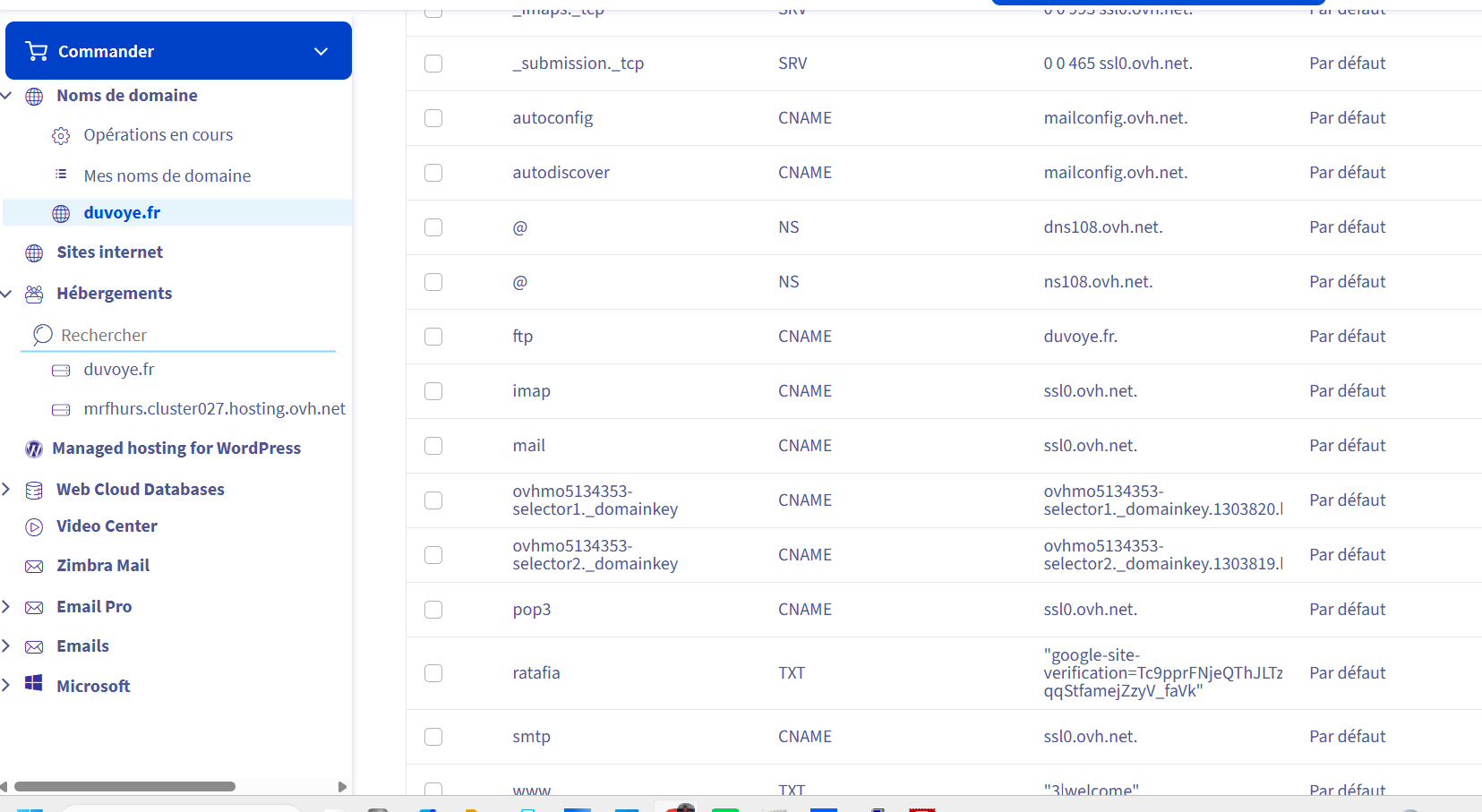

Thanks for your help: I did a bit of cleaning—removed all A and AAAA records in the domain’s DNS zones… here’s what I get for the domain’s DNS zones: there are still many left:

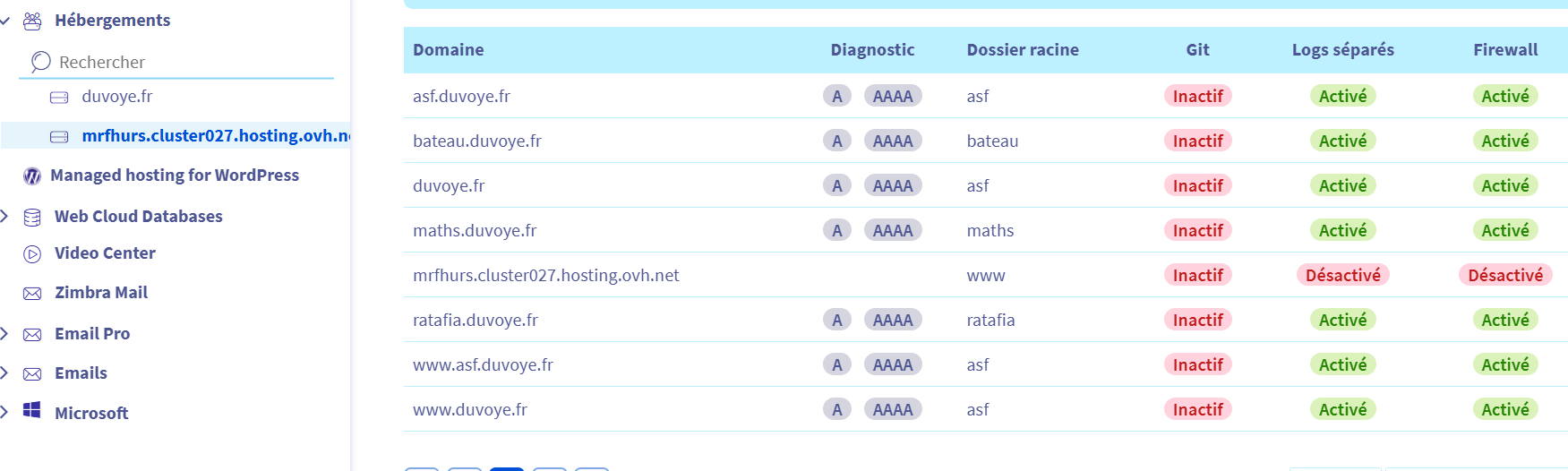

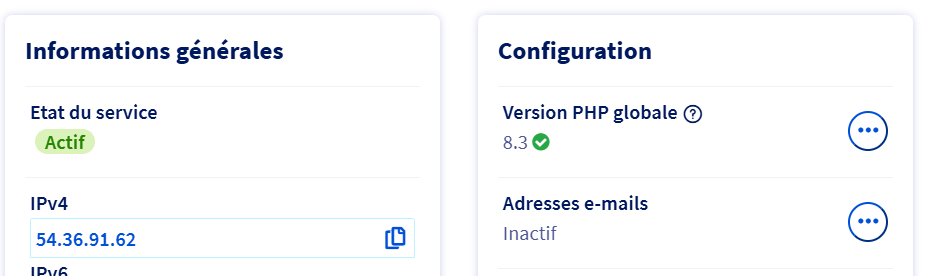

Now here’s what I have for the multisite hosting: it’s much cleaner, but the A and AAAA records are greyed out, so they’re not active yet; I’ll wait 24 hours.

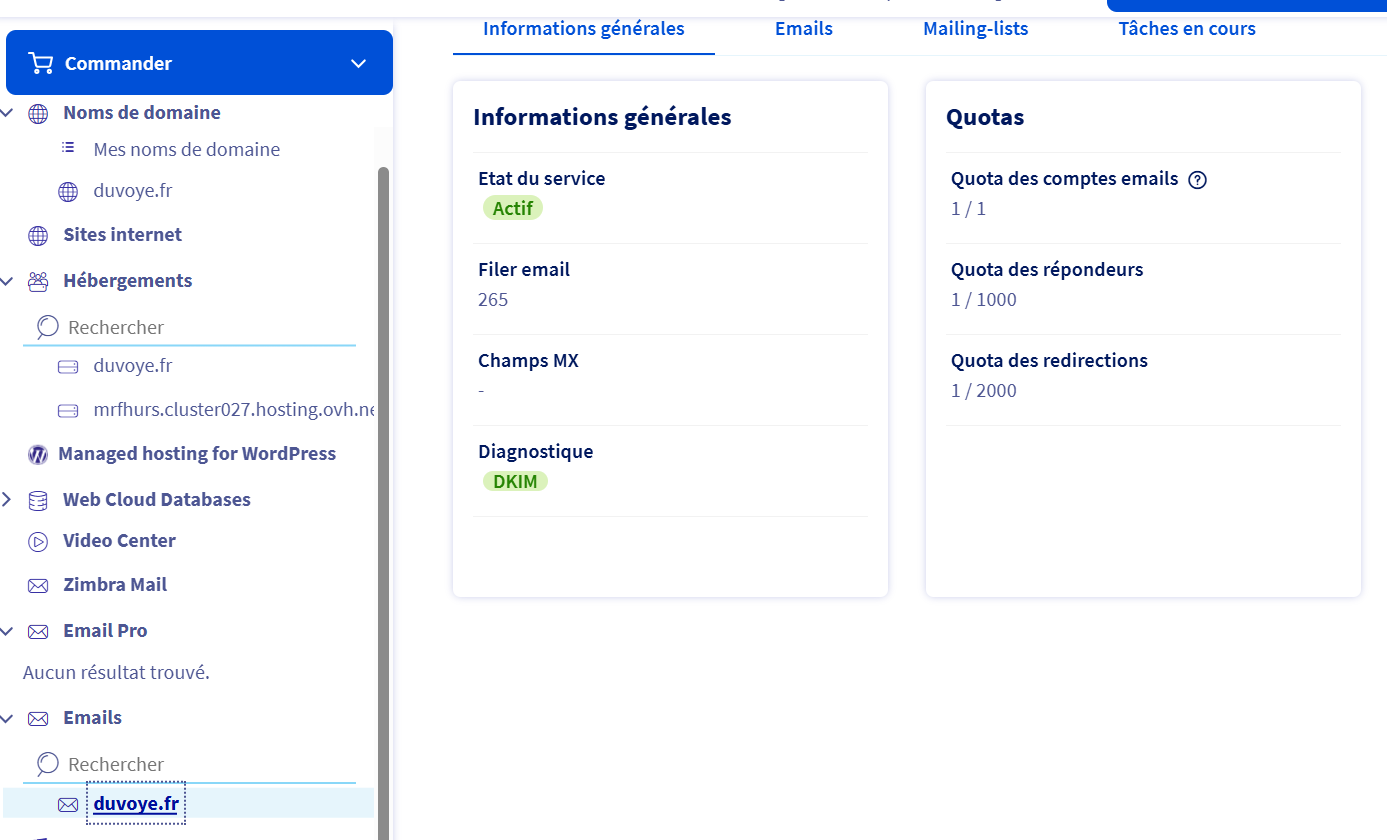

Regarding email: I had an Email plan with the VPS, so the associated redirects are on the domain.
I see that in the multisite hosting, I also have an email account, but I can’t activate it while the other one is active…

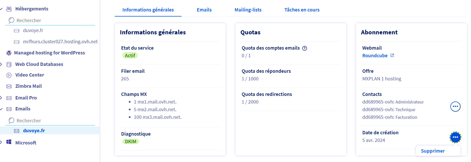

However, the one in the Email menu works:
I suppose I can’t have both at the same time on the same domain… which one should I keep? In the end I’d like a single contact address for site visitors: webmaster@duvoye.fr, forwarding to my Gmail and an autoresponder if possible.

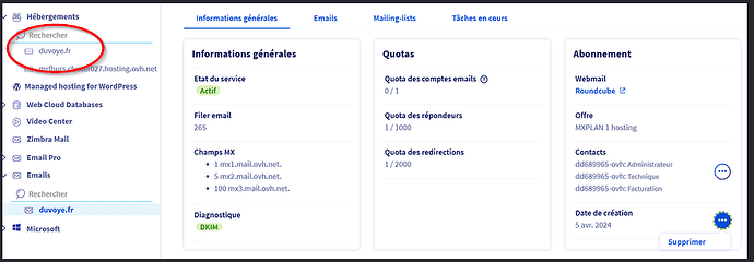

In your control panel you indeed have two hostings. Look at the left column, once: duvoye.fr and once: mrfhurs.cluster027....
That's probably why your e‑mails can only be activated on one of the two hostings but not the other...

Regarding the VPS email, it is disabled I think. But the Email option remains enabled on cluster 029, which is an old free hosting, too small, that I no longer use and for which I requested termination some time ago. I don’t know why it’s still there.......
So I’ll try to disable this Email function on cluster 029, and maybe I’ll manage to enable Email on cluster 027.......; for now that’s not possible. response: an email already exists for the domain duvoye.fr ..........

In your control panel you indeed have two hosting accounts. Look at the left column, once: duvoye.fr and once: mrfhurs.cluster027....
  • cluster027: that’s where my sites are
  • duvoye.fr: that’s my domain name but it has never actually contained a site. I get the impression that, like in my DNS zone, this thing was created a bit on its own

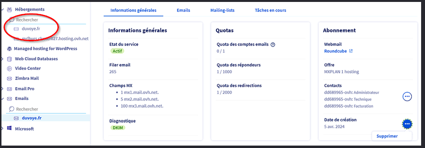

PS: it seems that cluster029 has changed its name!!!!!! and is now called duvoye.fr!!!!!!!
You choose whatever name you like, using the little pencil next to the title when you open the “hosting” panel.
This lets you identify them more easily.
So you have acquired a free hosting plan (start10m, start100m, or mailplan) when you purchased your domain. This free hosting includes a single mailbox.
You need to retrieve your emails and then cancel this free hosting that is preventing you from doing what you want. Unfortunately, this start100m will remain “in purgatory” for a month, and you still won’t be able to activate your mail on the other hosting.
You should open an incident ticket with OVH asking them to delete this cancelled hosting immediately and permanently; you can even request that they erase the mailbox and its contents. This will avoid a possible back‑and‑forth question.

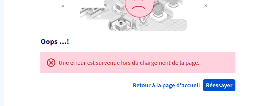

For now: I'm going to delete the Emil>duvoye.fr< (it's the only place where I found a delete):
It replies:
I don't know why
or maybe it needs some time to think???

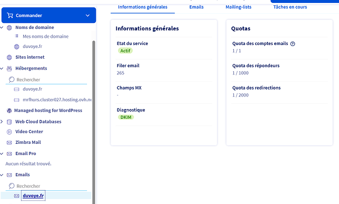

This is your hosting (make sure it’s the one to delete, okay!).
The email box is linked to it.
I have a termination date of 04/03/2027 ............ so the thing won’t disappear!!!

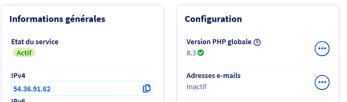

Indeed, Email is shown as active
But I can’t deactivate it
