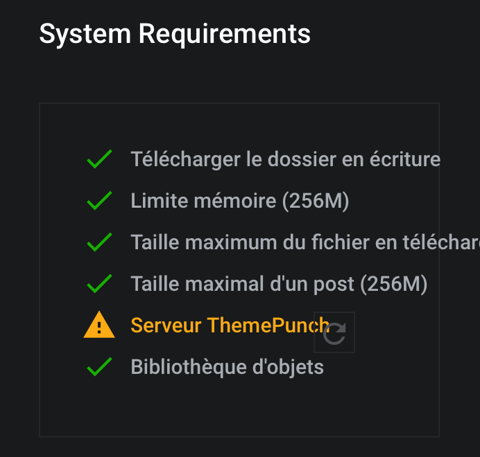

J'essaie de faire fonctionner Slider Revolution sur un Wordpress fraîchement installé, sans autre plugin.
Comme toi sur une version PHP 7.3
J'ai tenté d'installé la version la plus récente de ce plugin et une version plus ancienne (5.4.8.3) et rencontre le même problème que toi : le plugin ne parvient pas à se connecter au serveur de Theme Punch. Je reçois un message plus détaillé : "Error with contacting the ThemePunch Server
Please make sure that your server can connect to updates.themepunch.tools and templates.themepunch.tools programmatically."

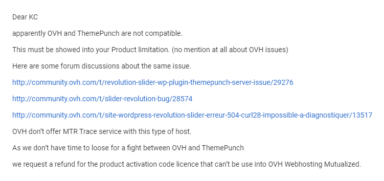

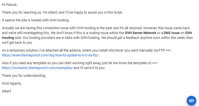

voici nos échanges avec le support ThemePunch:

Hey Guys,
I'm KC and I work as a Support Manager at ThemePunch in Cologne, we are deeply sorry about the connection issues we have with OVH hostings which affect the registration process for our products. It is our utmost priority to solve this issue. Also, we've received your complaints in our support system tickets and we will follow up closely regarding the updates we received from our end.
In the meantime, we have received updates from some users and they shared the responses below from OVH Support.
Hello sir,
Regarding your request, we have no blocking concerning these URLs.
It is necessary to contact the plugin in order to whitelister the IP of the
gateway of cluster026:
https://docs.ovh.com/fr/hosting/liste-des-adresses-ip-des-clusters-et-hebergements-web/#cluster-028 1] https://docs.ovh.com/fr/hosting/liste-des-adresses-ip-des-clusters-et-hebergements-web/#cluster-026
The IP in question:
91.134.248.211
The blocking is done directly outside, we let out the
requests.
Regards,
Valentin B.
IT Support Technician - Web
We've checked this with our hosting provider and there are no blocks to this IP address 91.134.248.211 or to any of the IP's listed [here. So, in order for us to check where the route goes down, we need the tracert for the below IP addresses from OVH. (Which we hope that OVH Support/Technical Team could provide for us)
*.themepunch.tools (Server IP: 176.221.47.226)
*.themepunch-ext-a.tools (Server IP: 188.93.11.115 )
*.themepunch-ext-b.tools (Server IP: 176.221.47.137)
Until then, we cannot help out further and we hope to hear from OVH Support soon regarding this matter.
Thanks!
KC
ThemePunch
