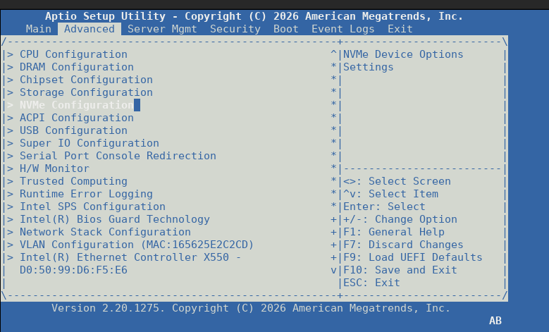

I was working on my servers and noticed that the BIOS selected menu item text is invisible when using IPMI SOL over SSH.
The SOL proxy appears to collapse the foreground and background colors of the highlight to the same ANSI color, making the text disappear. Client-side color remapping doesn't help since both fg and bg shift together. Needs fixing on the proxy side. Screenshots attached (KVM works fine for comparison), the disappearing menu in this case is NVMe Configuration

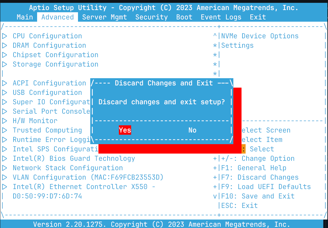

Was the second screenshot taken from your terminal or from the SOL to HTML viewer?

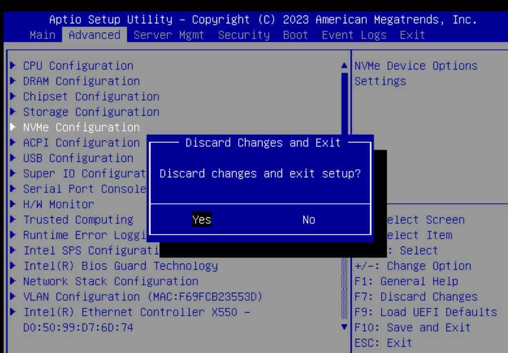

Second screenshot was SOL to SSH in my terminal. First is KVM over HTML. I just checked with SOL to HTML and it actually works fine there, which would, after all, indicate it's something with my terminal – but I swear to god I tried all things possible, in different terminals, shells, different fprint combinations, etc., to no avail.

On my gnome-terminal, the background is slightly grey so it works as expected:
