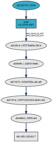

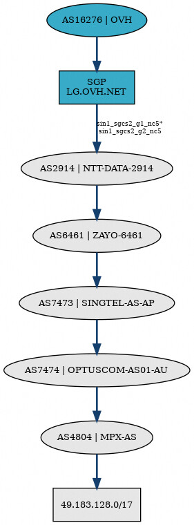

As can be seen from the diagram, the path from the server back to Optus goes through AS6461, which means that the data will detour through the US, which will greatly increase latency.
