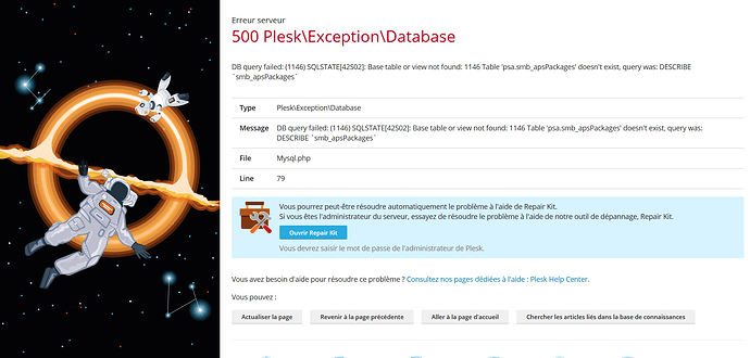

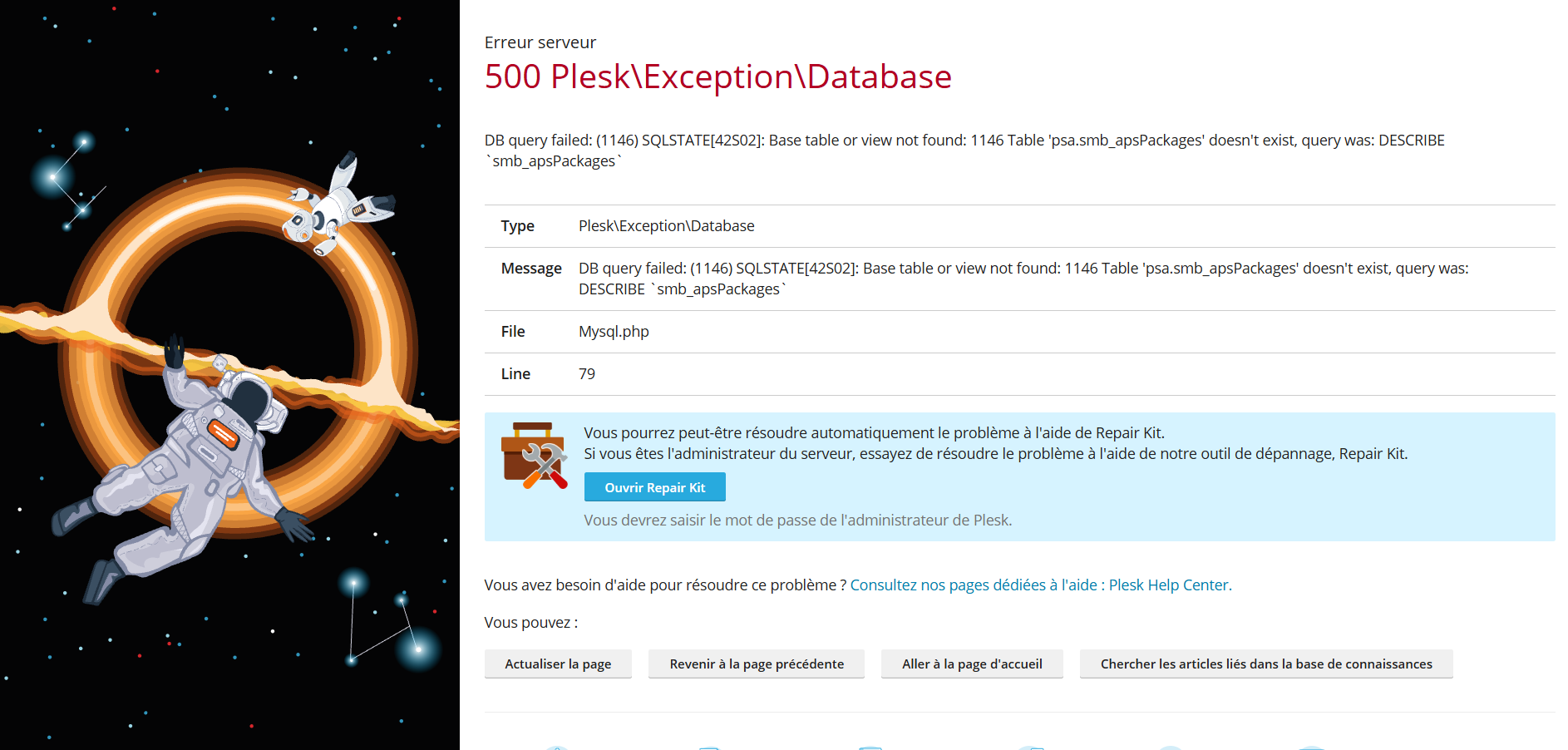

Here is the problem:
During the night of August 26 to 27, my PLESK server went down. At this point, the exact cause has not yet been identified, but it seems that an attempted update was performed without completing successfully.
I can no longer access the machine at all, whether via SSH or through OVH's SSH (via remote KVM); I cannot execute any restoration command.
  • When connecting with "Remote KVM", the program window opens, loads for a few seconds and then shows the following error message: "Connection failed!".
  • When opening with "Serial over LAN (SoL)" the interface displays "[SOL Session operational. Use ~? for help]" and then freezes (unable to type anything).

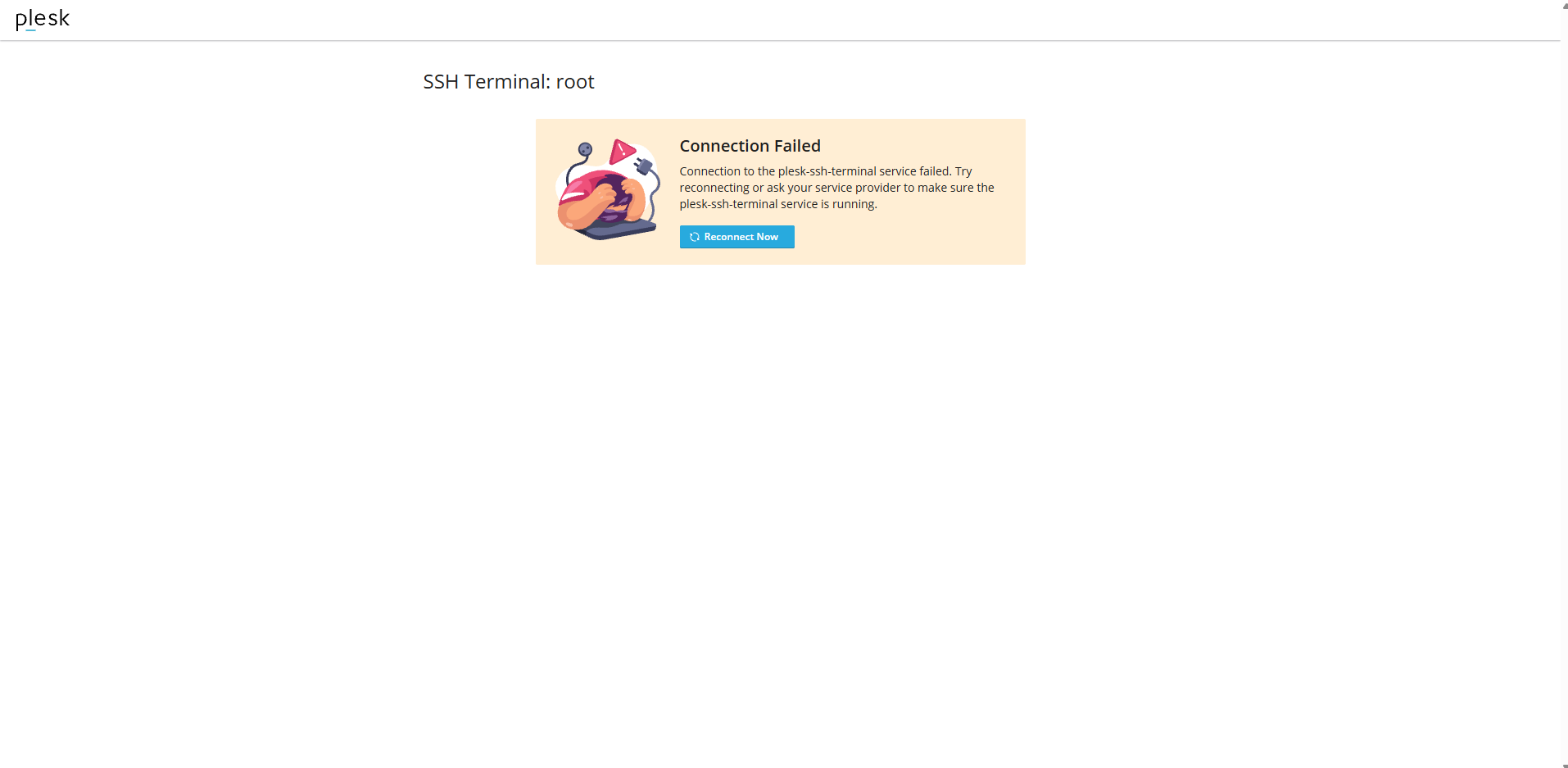

  • When connecting to "{my_plesk_server_address}/modules/ssh-terminal/repair/", it loads with the message "Connecting...", then a few seconds later the following error appears:
    "Connection Failed
    Connection to the plesk-ssh-terminal service failed. Try reconnecting or ask your service provider to make sure the plesk-ssh-terminal service is running."
Attached are the screenshots.

Hello @Julien_OVH
The fact that remote KVM and the SoL connection fail is a sign that the server is not fully booting up. It’s not a configuration issue; the system is locked or corrupted, and the remote access methods cannot establish a session because the operating system is not responding.
Since the ticket is not progressing, the quickest way is to call OVHcloud telephone support for your region.
