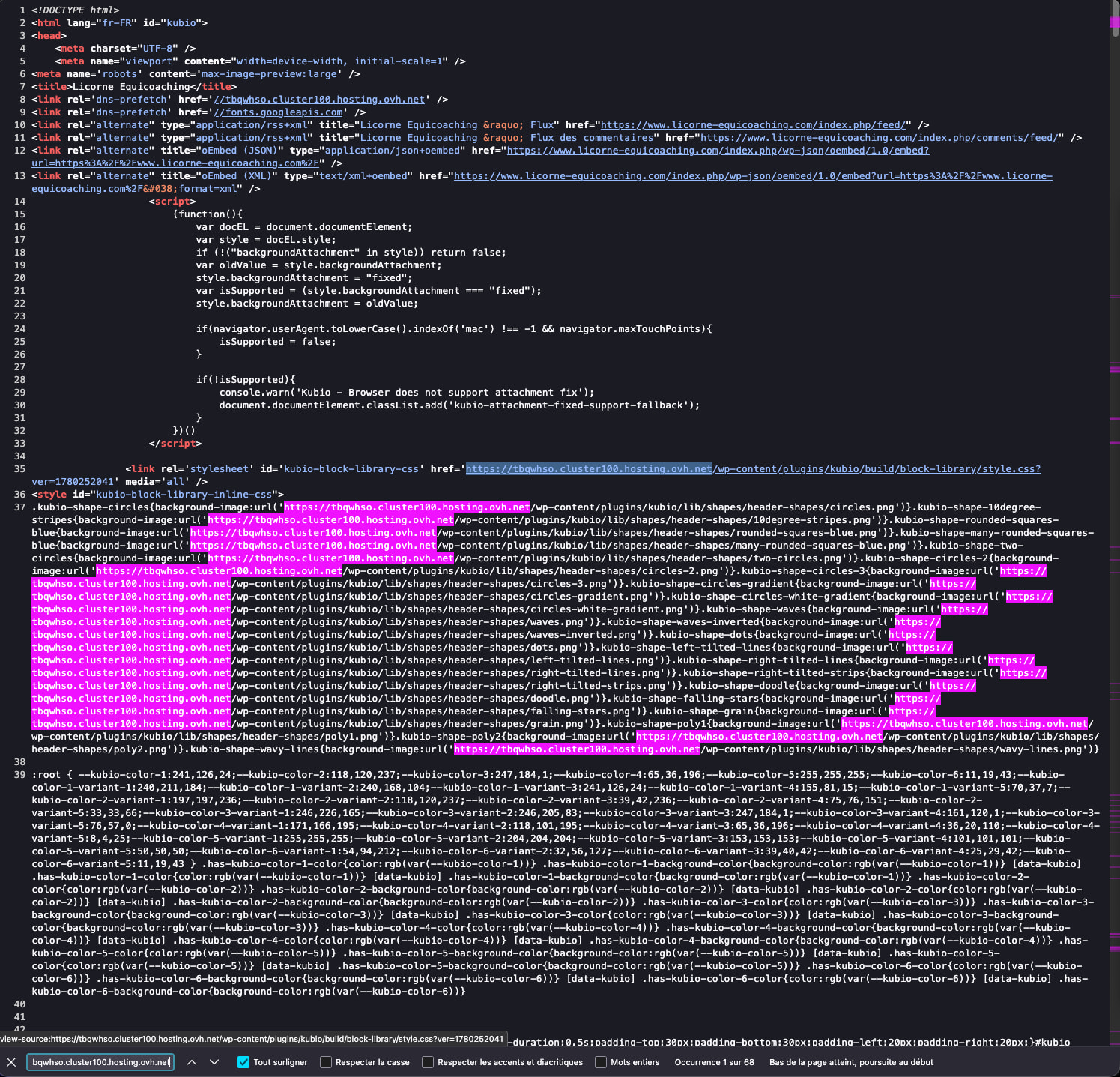

The “chaotic” display of the site is caused by mixed content, your site uses many links that use the address of your hosting cluster:
Make these links disappear by replacing them with “https//licorne-equicoaching.com” :wink:

I can suggest the Better Search and Replace plugin to help you avoid a full reinstallation of WordPress.

Again @Lolo974 a “one‑click” installation.
Fixing the address xxx.clusterxxx is easy to do. See the paragraph in my guide:
[O9 - Changer l’adresse du site dans toute la base de données – Plugin « Better Search Replace »](https://wordetweb.com/word-et-web/WORDPRESS-guide-installation-de-WordPress-premier-domaine-chez-OVH-FR.htm#_O9__- “O9 - Changer l’adresse du site dans toute la base de données – Plugin ”)
Sometimes, editing the WordPress site’s URL is enough to refresh all the site’s hyperlinks. Sometimes, unfortunately, it doesn’t work. In such cases, I recommend, just like @fritz2cat, using the plugin Better Search and Replace which works very well for this kind of need :slight_smile:
