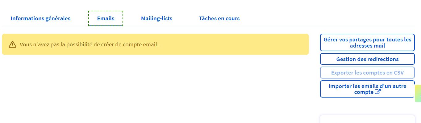

You cannot create an email account
The panel displays: “You do not have the ability to create an email account.” Could you check why the option is not enabled on my plan and unblock the situation, please?

“Create email account.” Could you check why the option is not enabled on my plan and unblock the situation, please?

Hello, see the Zimbra section. I think the created emails are now on the new Zimbra platform.

Hello, I do not understand how to proceed. The panel says I do not have permission to create email accounts. I also do not know which steps to follow or where to find the option. Could you please tell me exactly who can help me in order to know what I need to do or enable the necessary permissions?
