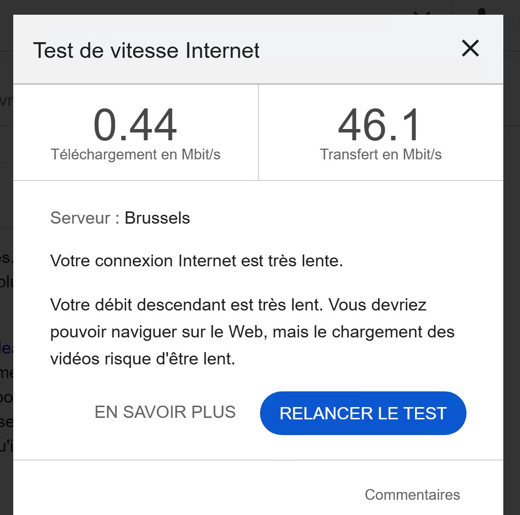

A speed test
  • 0.3 KB/s download
  • 30 KB/s upload
I’m far from the 400 Mbps of my plan
If anyone has an idea, I thank them

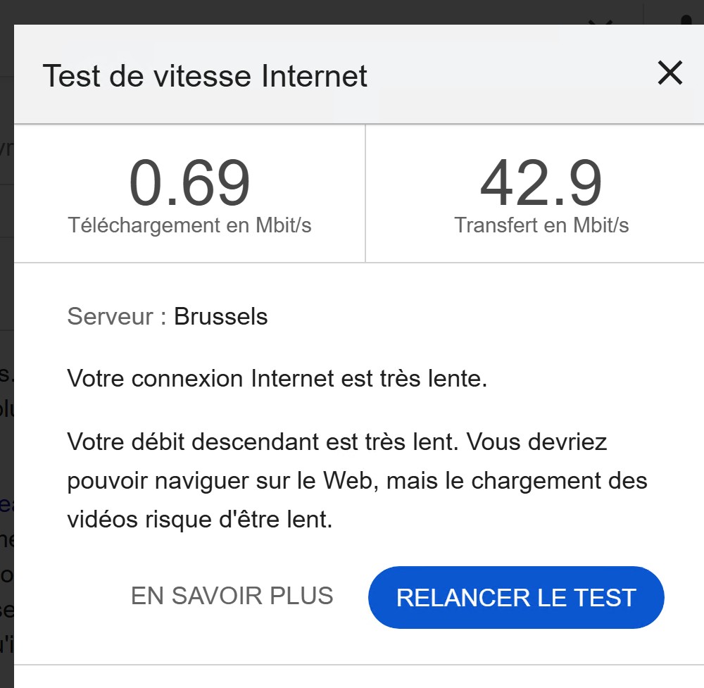

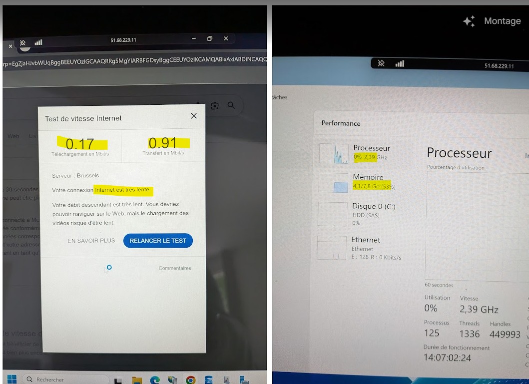

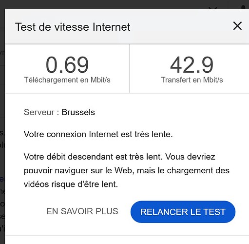

Below is a Speedtest from this morning, it’s catastrophic.
The upload has never been so low.
According to the Task Manager, nothing alarming.
The generic advice in this kind of case to start the diagnostic is to look for CPU “steal” time, which would indicate that another VM on the same host as you is abusing resources.
For the rest I don’t know Windows at all, so I’ll hand it over to the others.

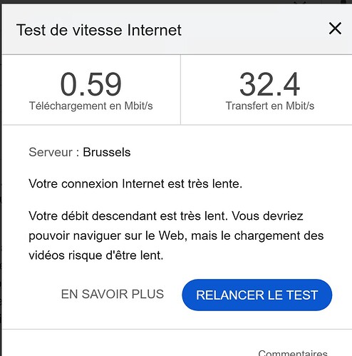

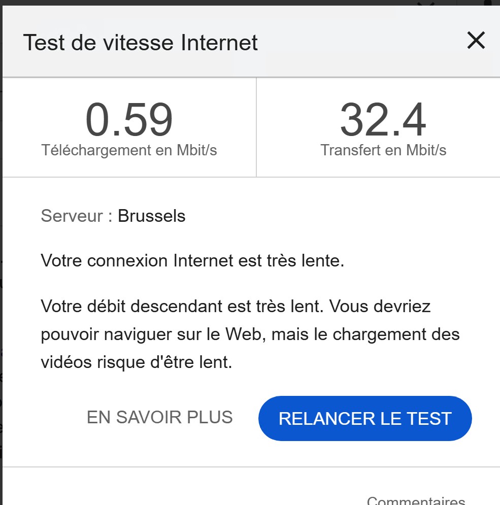

I just ran 3 tests :
  • Speed test with IIS and SQL Engine running
  • Speed test with IIS removed
  • Speed test with SQL Engine + IIS removed
The results are relatively identical even though I haven’t installed anything else on my Windows server.
The performance is terrible, right?

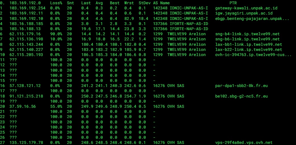

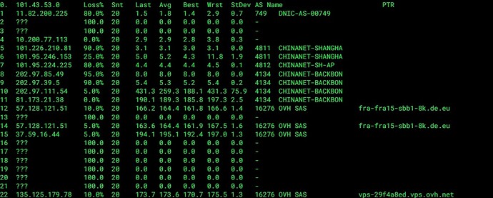

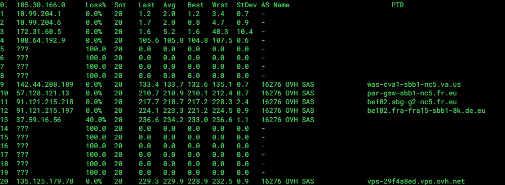

The ping to my new VPS is very high, reaching up to 250 ms, with constant packet loss. Furthermore, the number of hops exceeds 20. Could you help me resolve this issue?
I opened a ticket on June 29, but I still haven't received any response. Since then, nothing has changed.

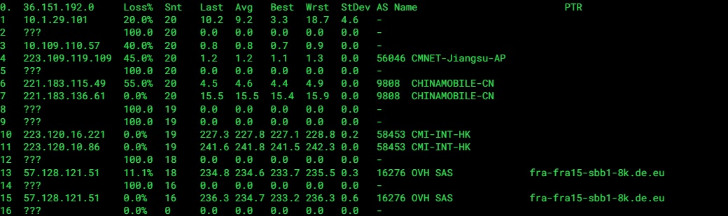

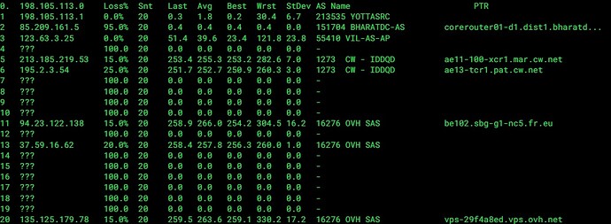

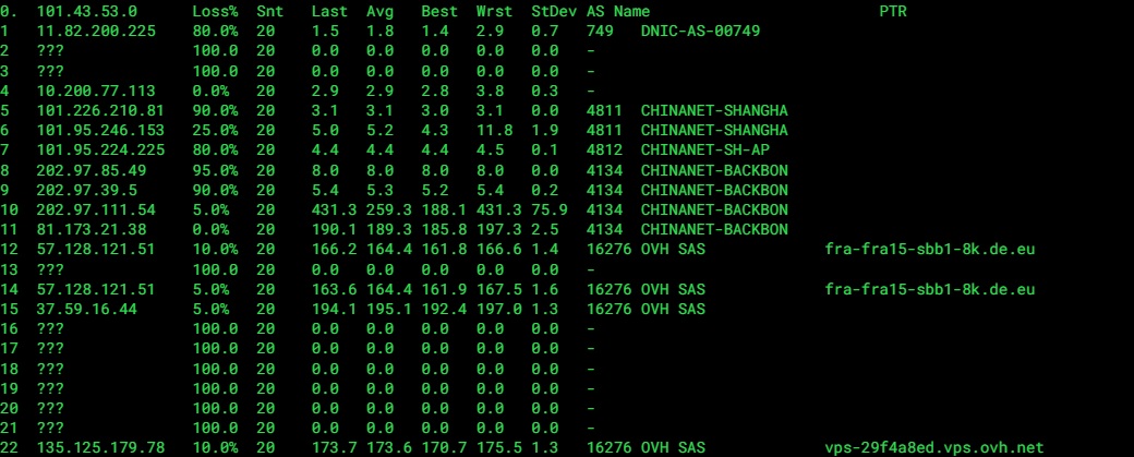

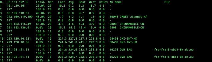

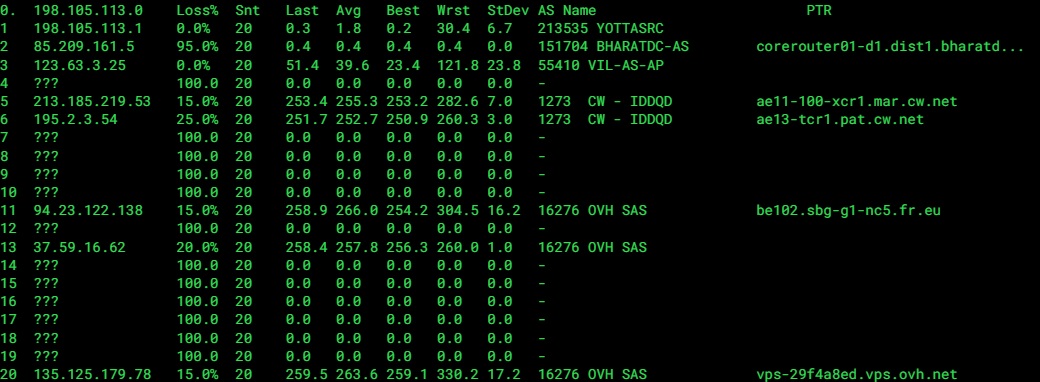

As you can see in the screenshots, significant packet loss is observed on the OVH side of the network.
37.59.16.56      55.0%  20    249.9 249.6 248.9 250.4 0.5   16276 OVH SAS
57.128.121.51    11.1%  18    234.8 234.6 233.7 235.5 0.3   16276 OVH SAS             fra-fra15-sbb1-8k.de.eu
 37.59.16.50      0.0%   20    458.7 460.8 458.0 471.8 3.7   16276 OVH SAS
94.23.122.138    15.0%  20    258.9 266.0 254.2 304.5 16.2  16276 OVH SAS             be102.sbg-g1-nc5.fr.eu
Hi @schamen
Since incidents like this, especially those affecting the backbone or network routing, are more complex and rarely can be resolved by an end‑user, the most effective thing is to reply to the ticket you have open and attach the full MTR results you captured.
