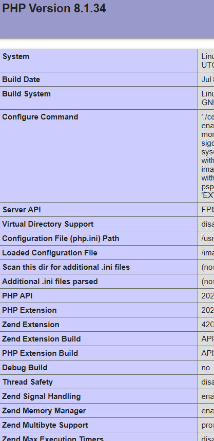

To confirm it yourself, the most direct option is to create a temporary PHP file with phpinfo(); and check the environment variables section to locate the PATH. If the command is available, it is usually found in the system's standard directories. If it doesn't appear, it's most likely not installed or the plugin is looking in the wrong path.

I created the phpinfo file. I get the configuration output, but what exactly should I check in it? You mention the “environment variables section”, uh what does that mean?
Rather than a small excerpt, could you provide the entire page?
Do a search on the page for the string zip
the page is very long...
for ZIP here are the relevant parts:
