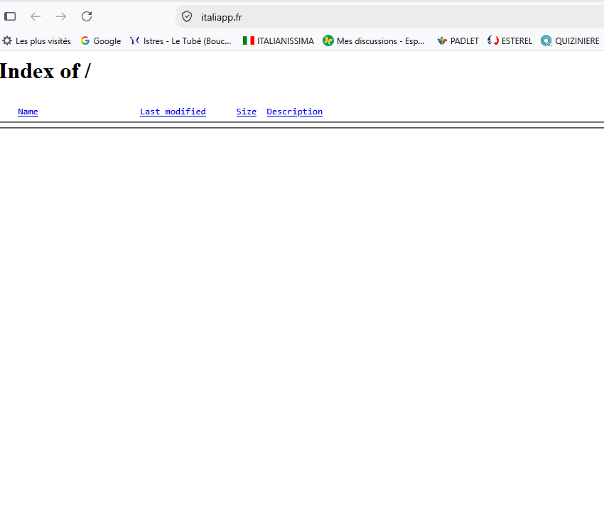

Thanks again for your help. Following fritz2cat's message about the difficulty with the same cluster, I managed to reach support by phone. The deletion of the old hosting was indeed accelerated and I was able to link my domain to my new hosting. I uploaded everything into the www folder just like with the previous hosting, but I end up with a blank index page showing the directories of my site, and to access my site I have to go to https://italiapp.fr/www/. In a hurry, I uploaded everything a second time to the root... Is that a problem? Should my site be at the root or in www, and if the latter, how can I make my address point to that folder?

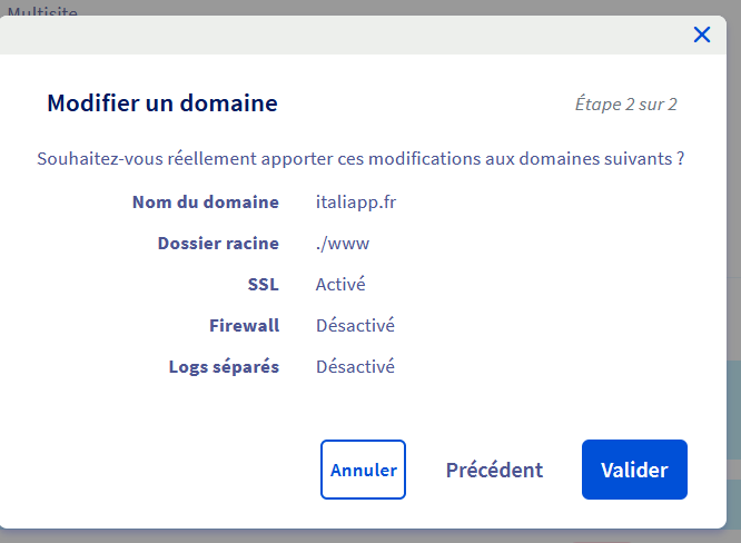

This Wednesday, September 16, 2026 at 18:18 https://italiapp.fr -> OK
But I quickly removed the modification and my site is uploaded twice—both to the root and to the www folder.

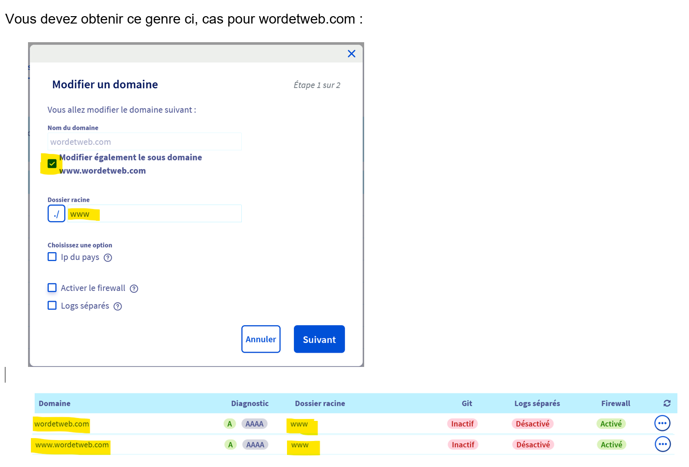

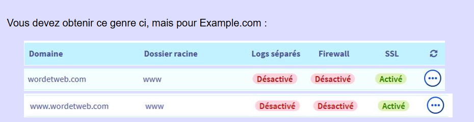

Excerpt from my guide:

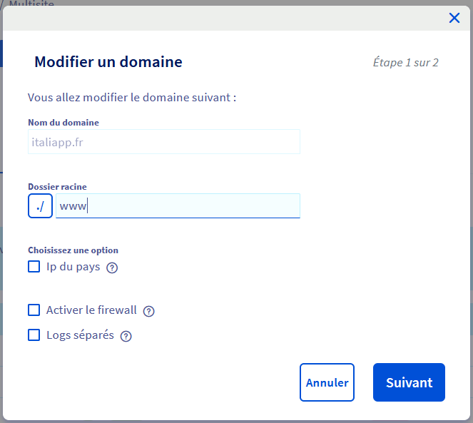

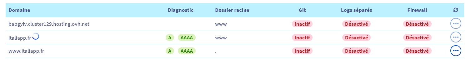

Yes, I saw it, but I don’t know how to add www in the "root folder" column. I tried clicking on … to add www in the folder, but it deleted my site (previous screenshot), so I have no idea what to do now.

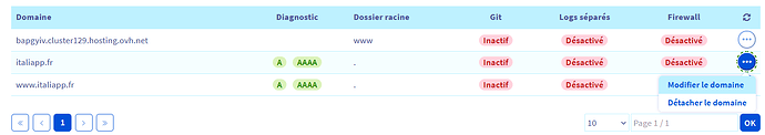

At my place:
It was when I tried to do that that I got this screen, so I quickly deleted what I had done and the site came back (but not in the www)

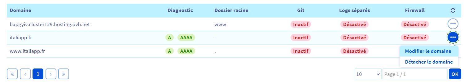

Can you make a copy for your site of the same copies that I previously provided for my site?

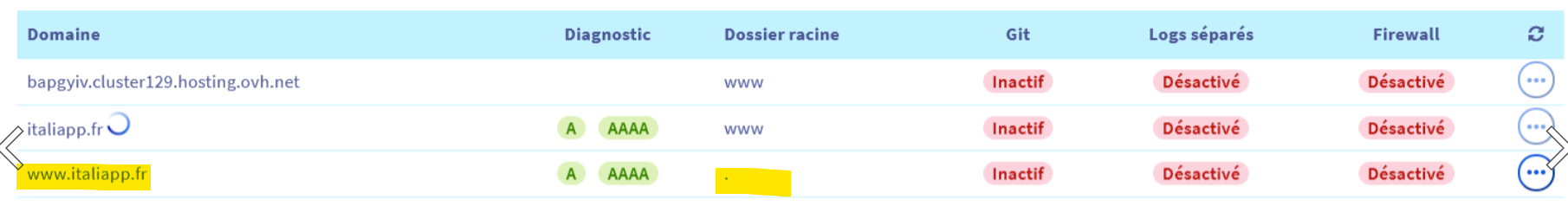

The root www folder is missing for wwwitaliapp.fr
I don’t understand how you can get this screen with "Index of".
Yes, I did it right after the capture. My site didn’t crash like earlier. There was a “.” pre‑written; I wonder if I put the www after the “.” or if I replaced it with www. A HUGE THANK YOU GASTON!!!! for taking the time to help me.
