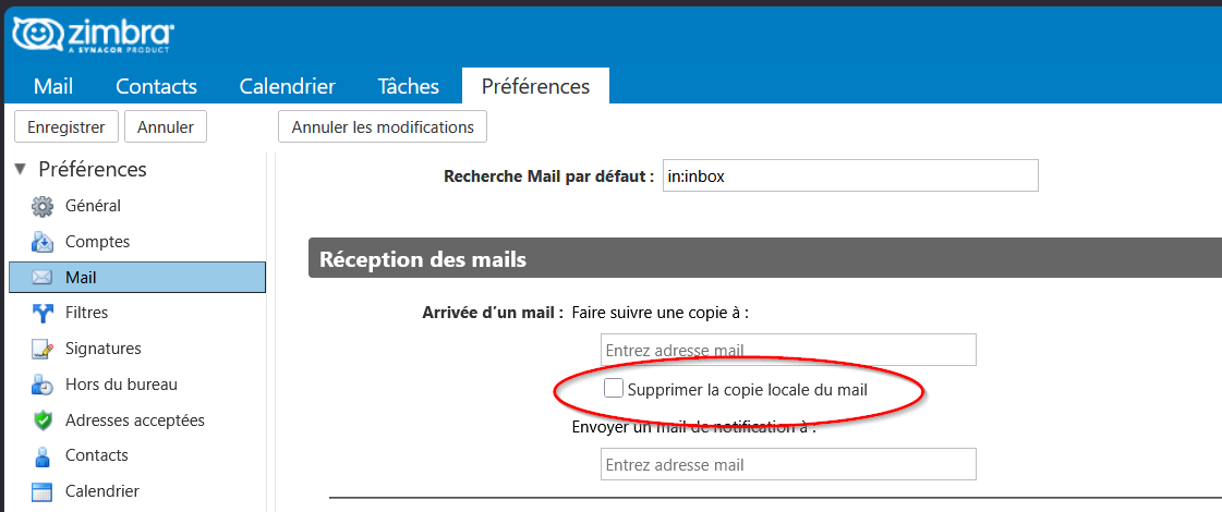

Hello @muriel1972
I just sent you a test email and it was redirected to a Gmail address.
Since your mail offer is a Zimbra Starter plan, here’s how to set up and edit redirects from the webmail: https://mail.ovh.net/
Step 1 of 3: Click the :gear: button at the top right of your webmail window.
Step 2 of 3: Click Settings.
Step 3 of 3: Click the Filters section from the settings window.
For more info: https://help.ovhcloud.com/csm/fr-mx-plan-zimbra?id=kb_article_view&sysparm_article=KB0062063

As you suggested, I went to check directly in the Zimbra webmail filters (Settings → Filters), and not only in the client area. I found a filter named “Gmail Forward” that, as soon as an email arrived, automatically forwarded it to a Gmail address without keeping a copy in the OVH mailbox, then stopped any further processing. Result: the mailbox seemed to receive nothing, while the emails were actually immediately forwarded elsewhere.
It was enough for me to disable this filter for reception to work normally again.
