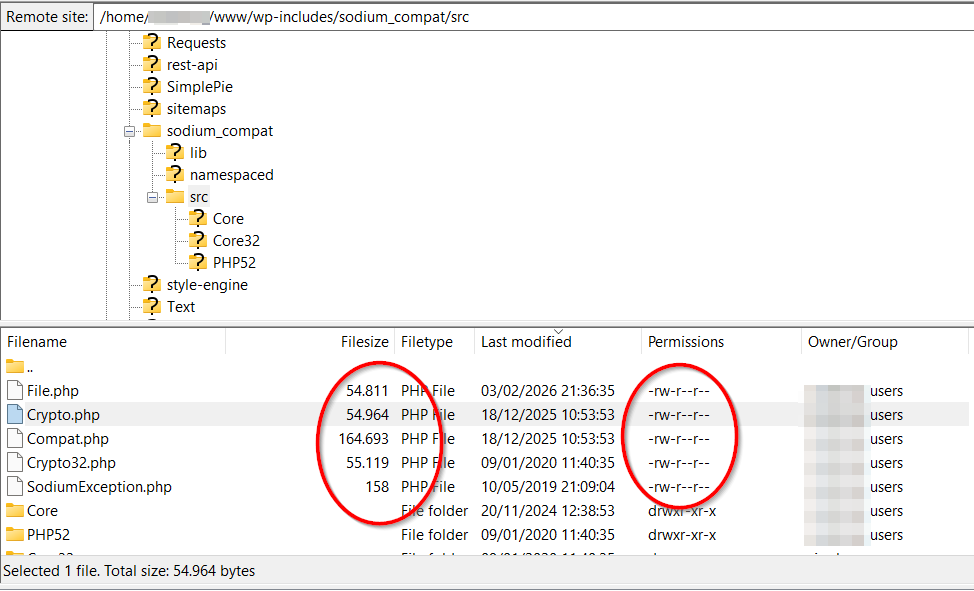

Hello,
I don't think it comes from a plugin.
Either your disk space is full, or there is a problem with the access permissions on that file or the folder containing it.
  1. Check where you stand with your quota
  2. Open Filezilla, navigate to this directory, and compare the file sizes and access permissions with what you see below:

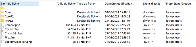

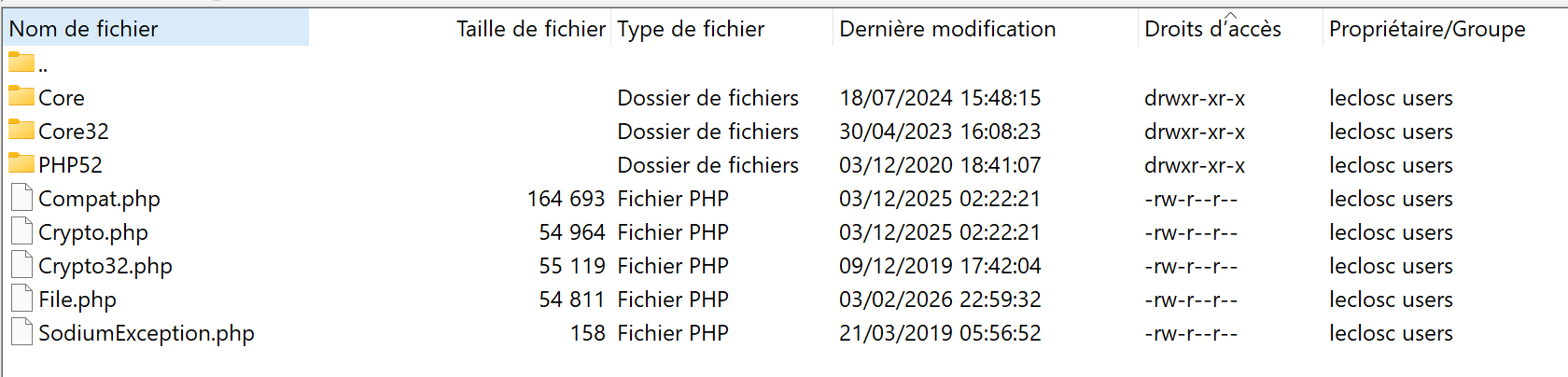

Hello @fritz2cat ,
Thank you for your reply.
I just logged into Filezilla, and I checked the file sizes, everything looks correct.
However, I don't have the Permissions column.
I have an Access Rights column. Is it the same thing?
I'm attaching a screenshot.

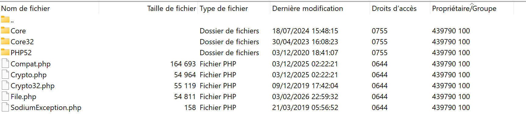

Hello @Gaston,
Thank you.
I just connected via SFTP.
Here is the display:
These aren't the same permissions as I have, but both are perfectly valid.
Honestly, I don't understand the source of your error.

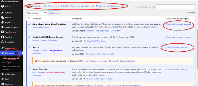

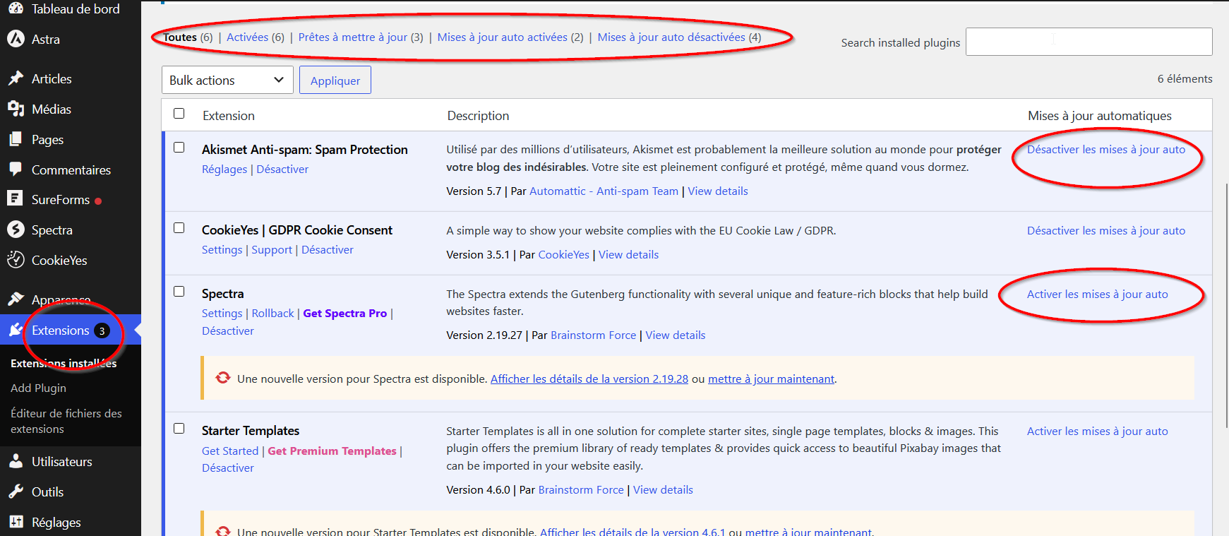

Hello,
OVH will not manage your WordPress installation. It’s up to you to do it, and the support response goes in that direction. Otherwise, they would need 1,000 more people in support …
Here is an example on a test site I installed recently in 6.9.
This site automatically migrated to 7.0 while my older sites require a manual operation to move from 6.x to 7.x.
On this site that automatically moved to 7.0, some plugins are not auto‑updating and I don’t know why.
